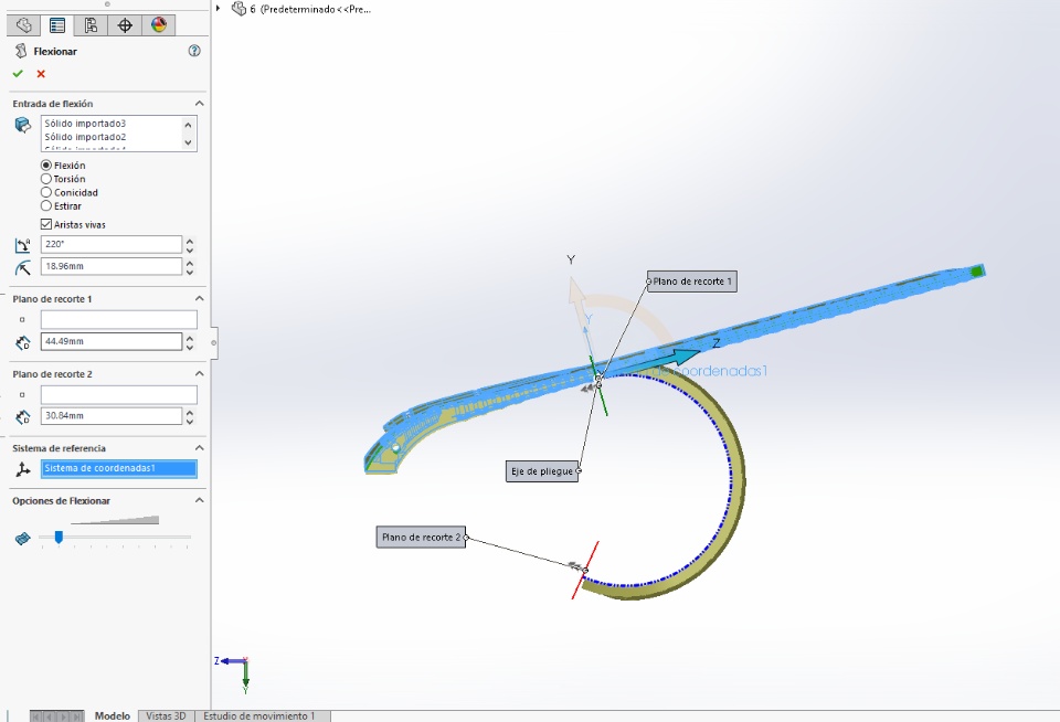

I need to flex a model on Solidworks 2016 , and my computer becomes slowed and later crashes, can not make this operation.
Microsoft OneDrive - Access files anywhere. Create docs with free Office Online.
I don´t know if the problem is on the model (heavy file) or on my PC. I Have 16Mb Ram, I7 2600K , GeForce 530, ssd hard disk
Can you tell me if I need buy a new Pc and what Hardware I need to make this type of operation with heavy files like the example on Solidworks very fast???
Would it be  enough buy a Quadro  Graphic card to put on my old PC???
Sorry for my English
Thank you very much.

Did you try sheet metal loft

Hi, thank you . The design is a leather watch strap Not a sheet metal model. I need deform a solid part.
VU
VU 2017-02-11
The problem is NOT in your hardware. I would recommend you to follow advice. Sheet Metal Tools has all you need to model the shape shown on your screenshot. Sheet metal part is still solid part but with extra tolls available for modelling.

The geometry is complex, so it will be slow.

The problem is the PC  is not able to calculate the flex operation.... 5 minutes....10 minutos....15minutes.....30minutes.... later  the flex operation is not posible and the pc crashed. My doubt is if I buy a Pc with a best hardware, I will be able to make this  operations with this kind of heavy solids parts with satisfactory calculation speed.

If you run Tools, Check, you will see that the imported geometry also has faults in it. You will have to clean those up either using Import Diagnostics, or cleaning up the problems in the original system that generated the solids before you will have success with subsequent modeling operations.
If you do get to the point of having a "clean" solid, one way to reduce the complexity before using the Flex command is to use the Split command to split the body into two bodies at the location where you want to bend it. Then you can run the flex command on ONLY the body you want to flex, reducing the complexity of the geometry that the flex command has to process. Even with those changes, I am not sure how successful it will be since this geometry is extremely complex. You may have to greatly reduce the complexity, removing the fillets in all of the little slots on the part to have a chance of bending it.

Yes, if I remove the fillets in all of the little slots and split the big part in two parts, I can  flex the solid very slow.  The solids have been modeled on Solidworks too, but for upload to this forum, I have saved the file like parasolid x_t, to make a lighter file.
Please, check the original  file  I have just uploaded with the modeling operations  (Please note the operations are suppressed)  and please tell me if it is posible make a flex operation with a new PC with a best hardware. I need deform the watch strap, to make product renders on Keyshot, This is why I can not remove any part of my design.

Flex feature requires a massive calculations and any PC will stuck with.
This is a sample of a belt model where sheet metal tools is involved.
1. Simple polyline.
2. Extrude from middle plane.
3. Cut off end tip.
4. Unfold and add holes.
5. Fold back to get the shape desired.
6. As a bonus flat pattern is available:
With Sheet Metal tools any configuration of hardware works very fast.

Are you really going to see all those tiny little fillets in a rendering? You would only see them if the rendering was of a very zoomed in area. I wonder if this type of leather is much better represented with a texture than trying to represent it with actual features.
I'm sorry, but I can't say whether or not this will perform better on a faster machine. It seems you are really pushing the limits on what is even technically possible. It may work on the very highest end machine, but it may not even work on such a machine and you may still need to simplify.
