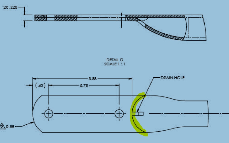

     Does anyone know how to deform(smash) the end of a tube like shown in the image below? The highlighted radius is what keep kicking my butt. I try lofts, surfaces, direct editing, everything I can think of. No luck:( I know we have punch press tooling that can do it - so I would think in should be doable in SW.
     FYI Its 1" O.D. x .109 wall tube.
Thanks,
Lee

Check this old (is gold) video Crimped tube in SolidWorks

I think I can make that work. It would be a lot easier if I didn't have to use all the surfacing to get the end result thou.
Thank you.
Lee
LW
LW 2017-08-10
Thanks for your help, but that really doesn't give me the radius(highlighted) like I need.
Thanks again.
Lee
JS
JS 2017-08-10
The process is a Stamping Process and that radius or shape is going to fully depend on the top die that does the smashing, this could be straight line as well, because all the flattening I ever did would have been a straight line because of the machine and dies available..
