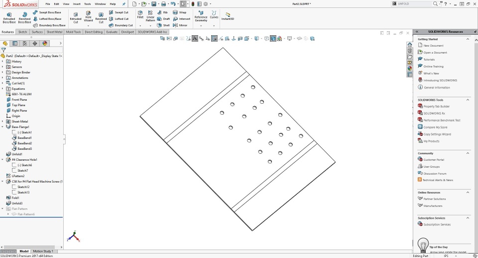

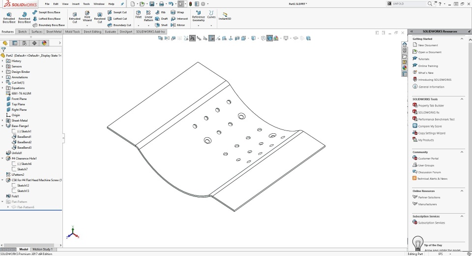

Here is the part in its folded state. The csnk holes are applied while it is in its flat state.

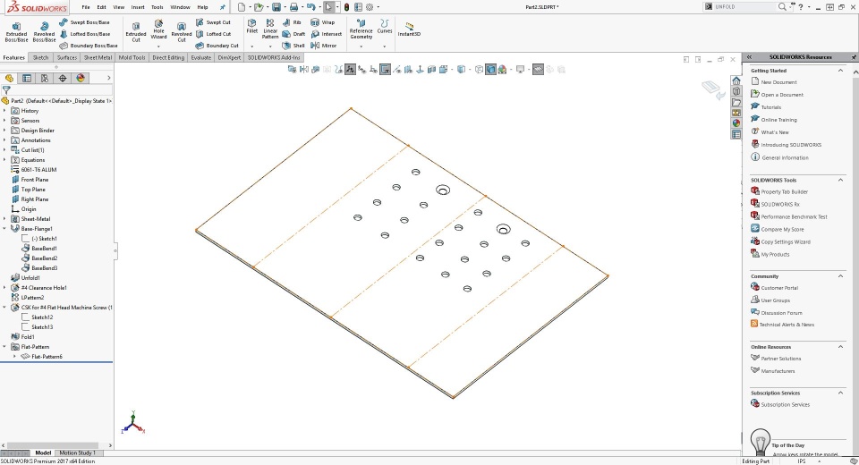

This is the resultant flat pattern. The csnk features are gone and are shown as a thru hole. The hole callout on the drawing is correct however.

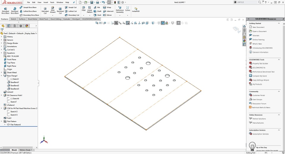

If I remove the csnk that is coincident with the pattern feature I get the expected flat pattern.
If I add an unfold right after the fold I get this mess.

It is not a service pack thing, it is a bug in SolidWorks and has been for a long time.

So here is a workaround
Fill in the holes where the countersinks go
Then add the countersunk holes and the flat pattern will be correct
