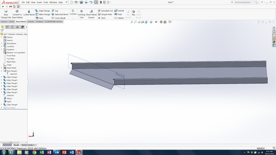

Suppose I have this part (imagine it like a standing seam that collects and drains the rain water). It is initially a rectangular sheet metal part, bended at the sides. Plane 2 is resulting from the assembly geometry, along it the part is cutted (split function).
I have to make now the flat pattern and export it as DXF. And here comes the problem.
At the inclined corners I get this double lines, which are of course the result of cutting the solid under a certain angle. For the cutting machine this is a confusing situation, each line meaning in fact a cutting line.
The only solution I found for this is to transform, inside the drawing, the flat pattern into a sketch and then, manually, remove all the strange line.
Do you guys know a more efficient solution here?
