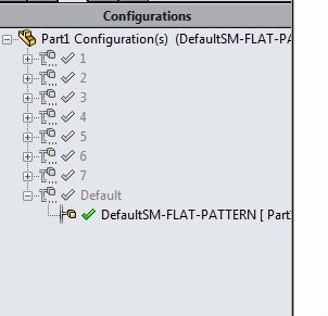

Hi,
How can check if FLATTEN features are unssupressed on all flat pattern configurations, and if are suppressed then unssupress???
Thanks!

Hi Hrituc
You can traverse sheet metal feature using this example: 2013 SOLIDWORKS API Help - Get All Sheet Metal Feature Data Example (VBA) . Get all features which came to the line: Case "FlatPattern"
get all configuration names: vConfigNameArr = swModel.GetConfigurationNames
then for each found flat pattern feature and for each configuration check if it is suppressed: 2015 SOLIDWORKS API Help - Is Feature Suppressed in Configuration Example (VBA)
then you can unsupress feature using this example:2012 SOLIDWORKS API Help - Suppress or Unsuppress Feature Example (VBA)
