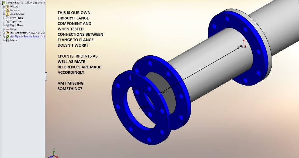

Dear Solidworks users,
Good Day.
I would like to seek your professional help regarding the routing feature of solidworks.
I already spent a week aiming to solve this problem I encountered.
This is regarding the flange to flange connections withing the same route assembly.
I attached jpg files showing my problem.

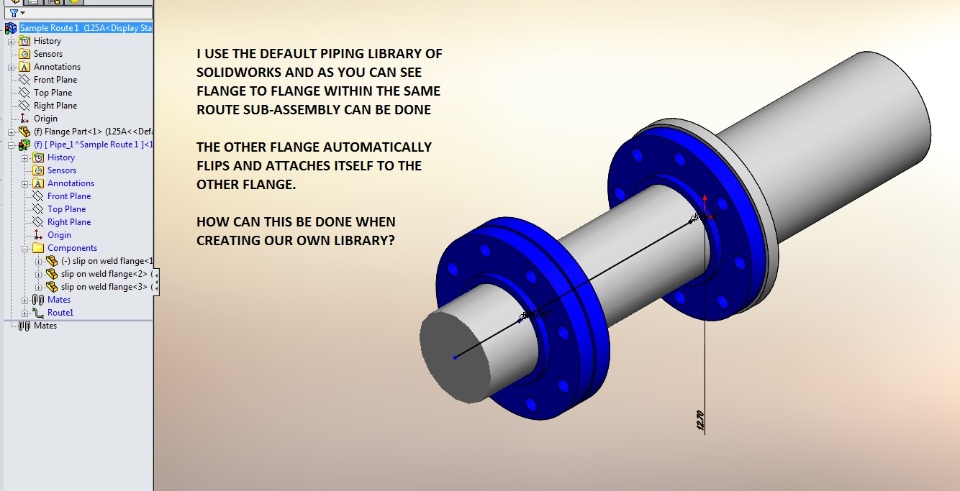

When using the Solidworks' default flange components I am able to connect flanges easily and it even automatically mate itself to the other flange.
however when I created our companies' own standard libraries and followed the routing wizard in creating flange it still fail.
I compared the solidworks' default and even tried to copy the settings for the mate reference, however it still won't mate.
Am I missing something?
I really appreciate your help on this.
We will be starting to use the piping library by next week and hoping someone can help me with this concern.

PV 2015-03-06 Best Answer
Randy,
If at all possible I would advise you to post the flange part. Or if that is not possible then a screenshot of the feature manager design tree and of the design table of the flange part.

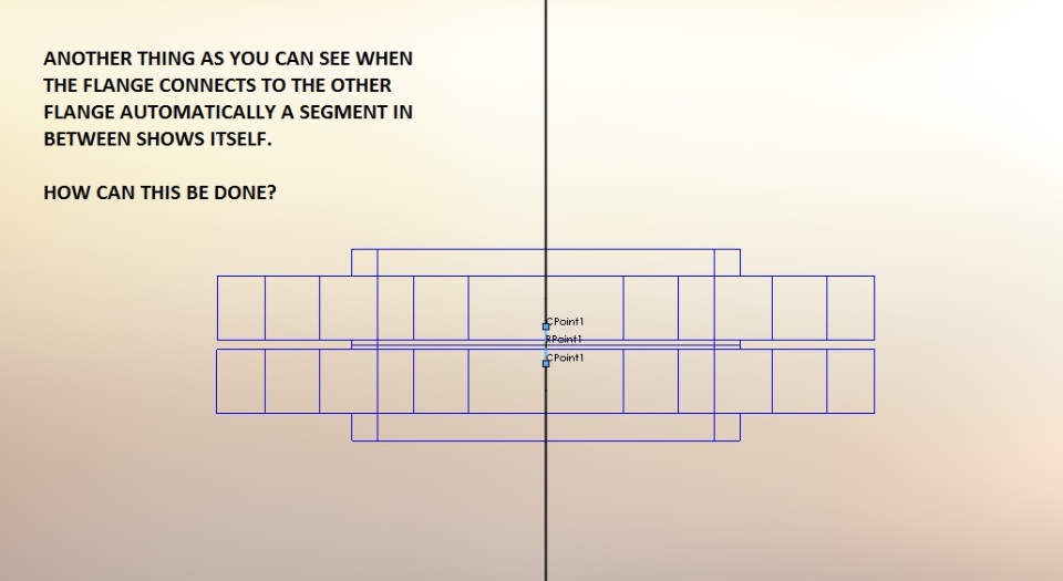

Concerning default piping library_2 about the segment between the flanges
That is normal
Cpoint = end of pipe
Rpoint = point on the route
Because the pipe doesn't end at the FOF it means that the pipe has to stop earlier, this so that the correct length of pipe can be calculated.
There isn't really a segment but just a part of the 3Dsketch of the Route needed so that the route knows that it belongs to the same route.
The reason it doesn't jump the other flange is most likely due to an issue with either the features or the design table.
