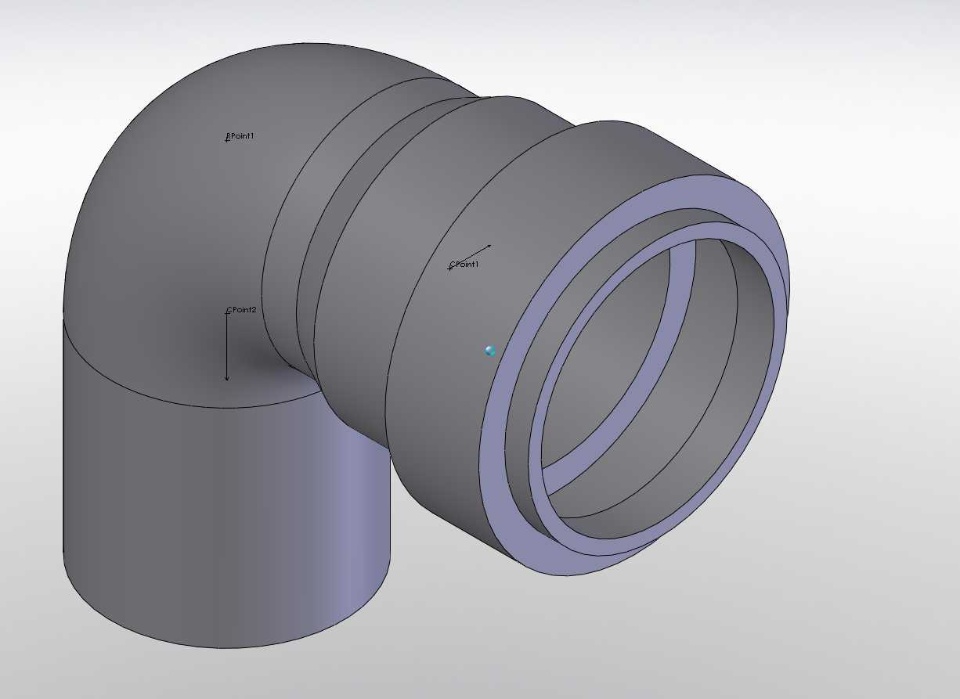

Standard an elbow is built up with 2 CP's and 1 RP. The position of the RP depends on what page of the manual you look at or what part of the provided library you depend your elbows on. It can be no RP, 1 RP coinciding with one of the CP's and 1 RP on the crossroads of the construction lines.
You can even come across elbows that are really special (see inclosed pic, look at the vector of the second CP)

Elbows are different to most other pipe fittings in that they do not have a route point - see the attached elbow for reference.
I have also attached a flange so you can see how it was done.  I agree with you about the face of flange comments, even though the route point for this flange is at the flange face, any dimensions that you put on the route sketch are for the pipe length (i.e. from the CPoint) and not from the flange face - a bit of a pain - this is further exacerbated when you do the drawing and use 'Insert Model Items' to add the dimensions from the route sketch, you then have to manually add the dimensions from the flange face.

I did not use the vertical axis as most of the basic elements of my library were created in 1999/2000 and I cannot recall that being available back then (I should extract the digit and revisit much of the library to see what affect all the new routing features have made to them).  You will see that the flange is modelled with the holes straddling centreline so in most cases it behaves itself (if the pipe is horizontal or vertical).
Yes the 2mm gap is for weld gap - this way the cut length of the pipe is about right; however, weld gaps will vary from material to material and material thickness, etc.  A minor annoyance is if you place 2 fittings back to back you end up with a weld gap of 4mm instead of 2mm :-(
