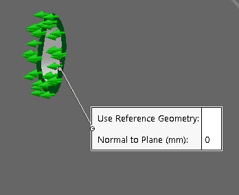

Dear Community Members/Support,
I came across an issue pertaining to a direction symbol for an applied fixture.
Fixture is being applied using a reference geometry (plane) and direction to normal to the referenced plane is restrained.
With this configuration the direction of fixture as seen in the model is shown below,

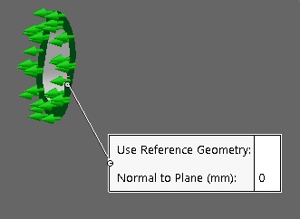

When I check the Reverse direction toggle still the direction of arrows are not being updated.
Still, I see no change in the applied direction of the symbols appearing in the model,
This always confuses me. Whether the problem is with my understanding of the concept or something in the tool is not working as expected?
Also, I have another couple of questions in this regard,
Is there anyway to completely restrained the translational motion of the object in a particular direction with a single constrain?
If Roller/Slider can apply a restrain in either direction then why the symbol shows the application in only one way?
May be you can guide me with my amateur questions.
Best Regards
Sarvesh
SolidworksSimulation
Answers 3
RD
RD 2017-10-01 Best Answer
Hi Sarvesh,
The arrow is not switching when you use 'Reverse direction' in this specific case because mathematically 0 == -0; arrow direction does not matter for the translation value you have specified.  If you were to use this fixture with a non-zero value you would then see the arrow change direction to represent the true direction of the prescribed displacement.  For a zero value the arrow direction being flipped 180 degrees has no meaning.  However, knowing that the arrow is acting in that direction is important as the face this fixture is applied will resist movement in either the arrows direction or the opposite direction.
