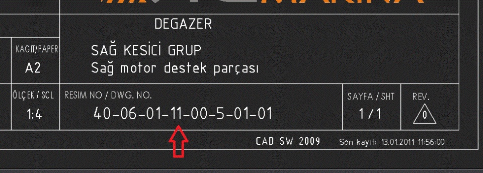

Hi, How can i write first 22 character of part filename in drawing title? For example;
solid file name --> 40-06-01-11-00-5-01-01_sag_motor_destek_parcasi.sldprt
in drawing title --> 40-06-01-11-00-5-01-01
is it possible without write a macro?
Not: please look at the attach.

Welcome to SW forums Burak
The only way will to write a macro which can be inserted in the part template (in part properties) and then all your files will have the Part No set to 22 characters of filename.

https://forum.solidworks.com/thread/31085?start=15&tstart=0 is the same question with a lot of explanation of how to do what Deepak suggested.

And in case you need the property to be configuration specific, just modify the code and add the configuration name.
"dummy"= part.Extension.CustomPropertyManager(add the configuration name here).Set("partno", Left(part.GetTitle, 22))
