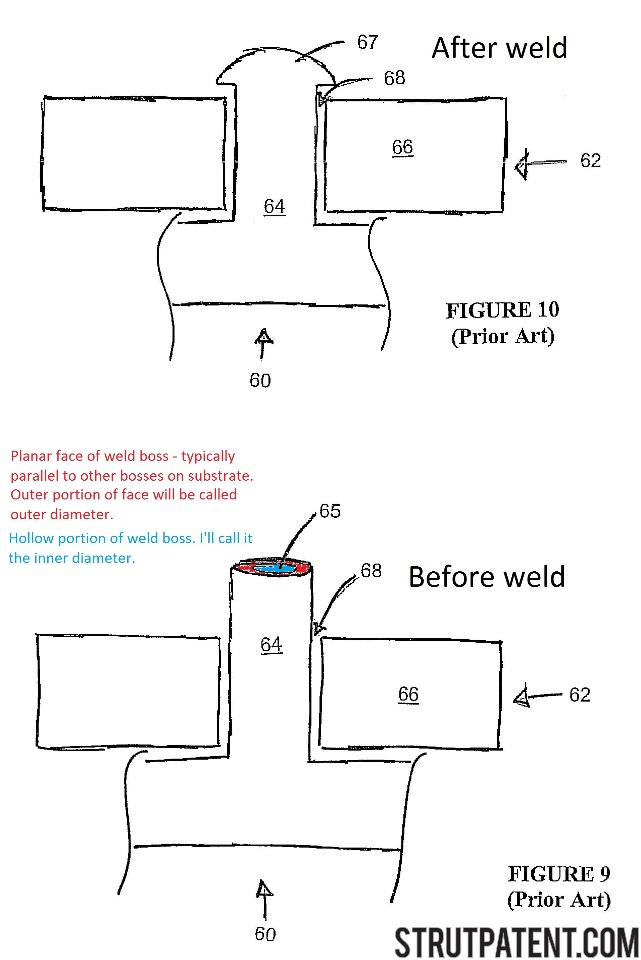

Because of confidentiality agreements, I probably can't upload pictures or files of customer parts, but if you're familiar with interior components, there are things we refer to such as weld bosses or stakes. These are simply a hollow cylinder extruded from the substrate of the underside of a part.
These bosses are closely related in that they are often the same diameter and have a hollow center, therefore, it seems viable to find them based on these parameters (outer-diameter/inner-diameter) and even sub-categorize them based on which ones are parallel to eachother, etc.
