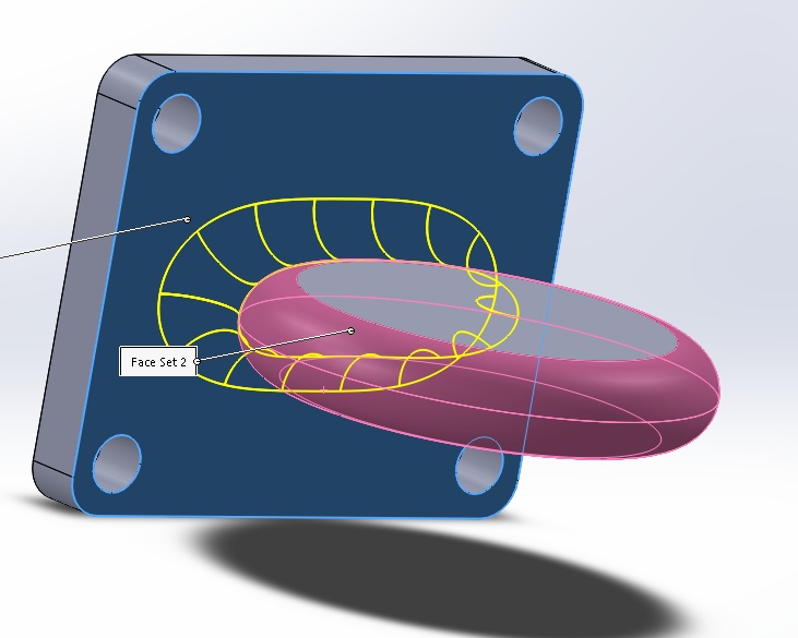

I am trying to fillet these two bodies together from how it looks in the photo
and I keep getting the "Multiple bodies not supported for this feature" error. I have attached my drawing
SolidworksParts And Features
you will need to either add material to connect the two bodies, or use surfacing tools to make the shape and then bring it all together with intersect, or similar feature.
IS this what you want?
