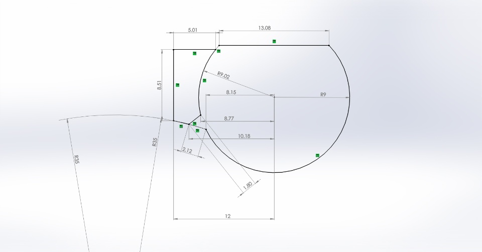

Here are the side dimensions of the piece. If it looks collinear to the x axis or y axis, it is. If I'm missing any dimensions you guys need to know, feel free to message me of course, and I'll answer as soon as I can.

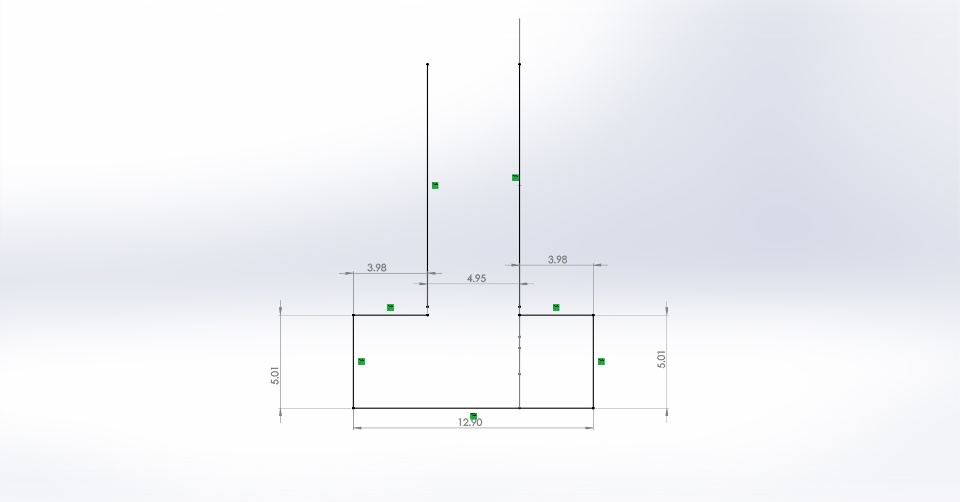

Here are the top dimensions. As you can see it's 12,9mm wide, and the center is 4,95mm wide. It is symmetrical. Keep in mind that the vertices in the center are not attached to the horizontal due to the shape of that piece as seen in the side dimensions. I made this piece by converting over the entities that will be cut, and then mirroring them over a mid plane for both sides where I would simply just extrude cut on both sides.

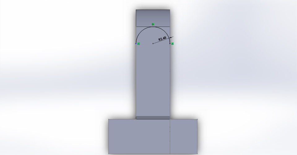

Here is the problem. I want a fillet/rounded edge all the way through this circle, however fillet refuses to work for me here. It has to be a full fillet, but the maximum radius the fillet will give me is somewhere around 2.3mm leaving a small flat on the front of the surface.
As shown here.

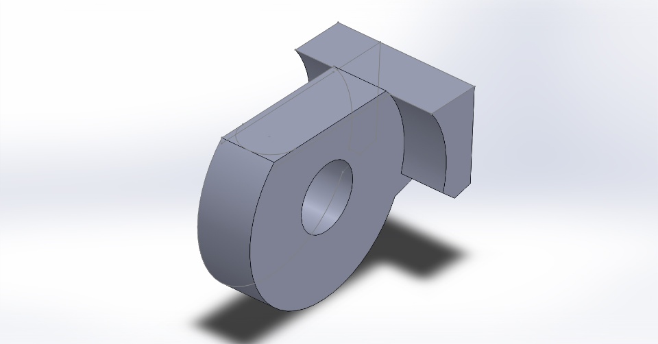

Here is a picture of the piece.

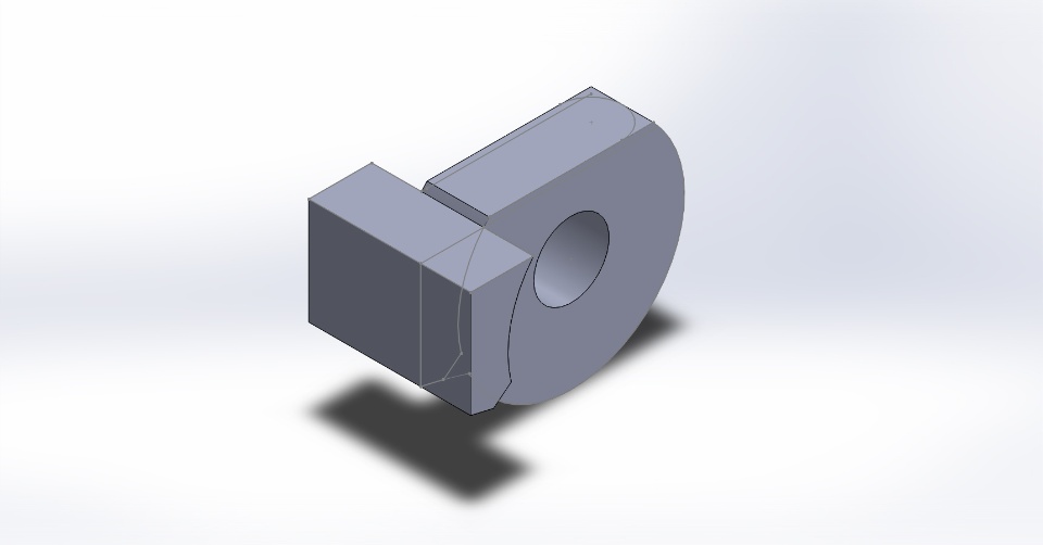

Another picture of the piece.

Choose the "full round" option within the fillet feature. You will need to create a new fillet feature for this. The circle doesn't have tangency to the straight line or flat face on the narrow portion of the circle, so the fillet doesn't follow up this edge.

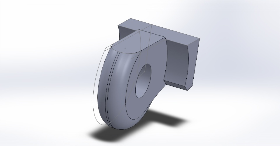

The problem is that as the radius approaches the desired value (2.475) there is a point where it can't be solved because of the curved edge coming off of the circular portion. Somewhere around 2.3mm that edge becomes tangent to the inside of the radius, and if the radius were any bigger then they wouldn't intersect and there would be no valid geometry.
I don't know what you end goal is but if you also fillet that adjacent curved edge then you can do a full round fillet.

Thank you! I didn't have filleting that edge in mind, but I don't have a problem with that. I'd also like to thank you for explaining to me why it doesn't work. I have learned from that. This totally works.
SF
SF 2015-07-27
Here she is.
