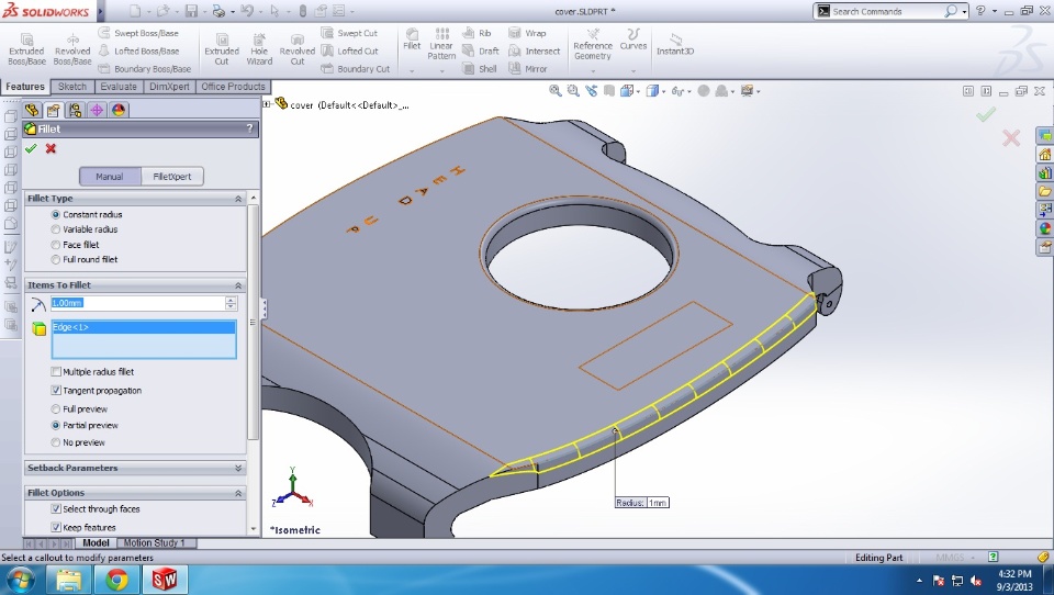

Good day! Can somebody help me regarding fillets. I just encountered this problem... Please see attached pics....
Will be grateful for your replies!! Thanks

Seems that fillet is acting weird, instead of producing a curve its not working

It looks like you have the option to "Keep Features" selected, try unchecking it.

I tried removing "Keep Features" from the option but still its not working, still producing the image "problem1" any other solution?? Thanks

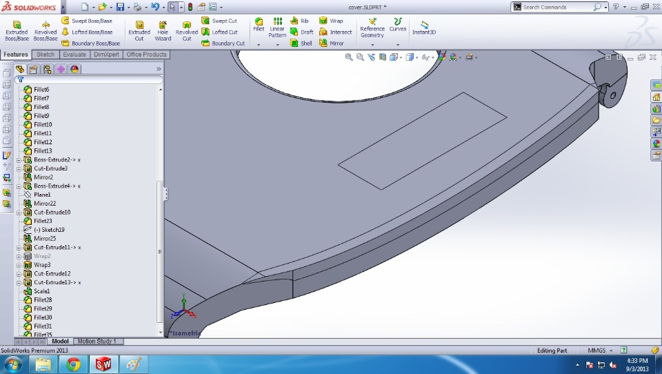

When i fillet the corner as shown in pic "problem" it would produce the image "problem1" and when i fillet again sa image "problem1" the problem is solved.. What is happening??? hahahahaha

I assume that you expect the fillet to continue along your chain of edges and, because it doesn't continue (tangent propagation), that's the problem you see. Let me know if you have a different problem.
I suspect that one of the edges where the fillet stops is not tangent, either on top or on the side. It appears you have chosen to display your tangent edges as solid lines. That makes it hard to diagnose, because you can't tell tangent from non-tangent. Either hide tangent edges or show them using their special line font. Do that and the offending non-tangent edge should appear.

Do you have more than one solid body in the file?  Looks like the fillet may have worked, just you have two copies of the same solid body?   Can you post your part file for us to look at?

I believe Mark is right. Most likely you have 2 superimposed bodies.The fillet has been applied to only one of them.

Yes Mr. Mark Kaiser you are right, i was having 2 solid bodies. But how come i had that one? and also what is the purpose of that solid body? Many Thanks.,..

Most likely in one of your geometry creating features (an extrude boss, loft, etc.), you unchecked a 'merge result' option.  Move your rollback bar back one feature at a time, and see which feature creates your second solid body.
