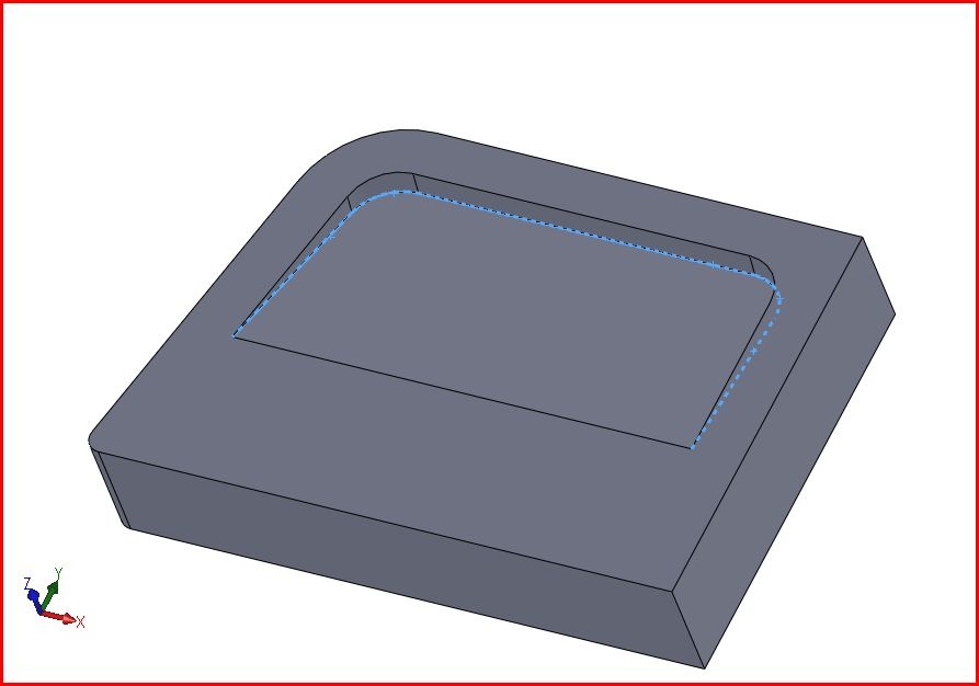

fillet in angled recess
I need to insert a fillet of constant radius in the highlighted corners of the recess.  The radius is greater than the maximum depth of the recess, and the outline of the recess in the surface must match the drawn profile.  I assume this is possible in SW but I can't get the fillet tool to work.
The attached project is in SW 2010.

DG 2011-12-27 Best Answer
Did you tried using face fillet option??

Hi Bevin,
classic problem - here's a solution for this type of problem

Thanks Deepak,
I should have been more adventurous, it was too easy.
