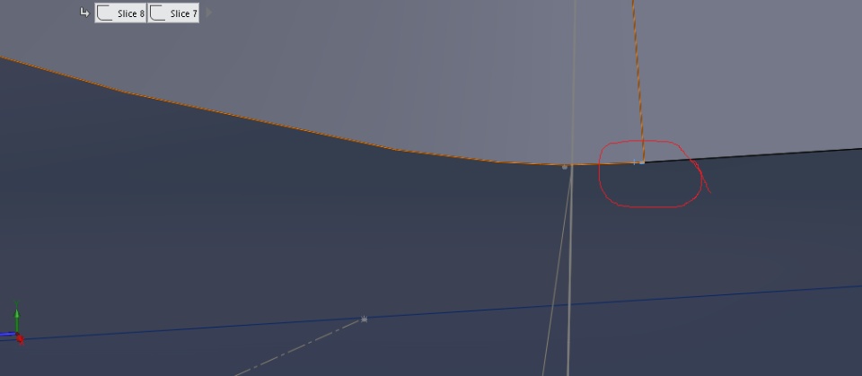

Joshua,... at first look,.. it maybe related to "Slice 8" or how Loft12 creates a vertex and later VarFillet1 runs through it.. and it becomes a segment (.0005")?...  (image attached)
comment imagecomment image
