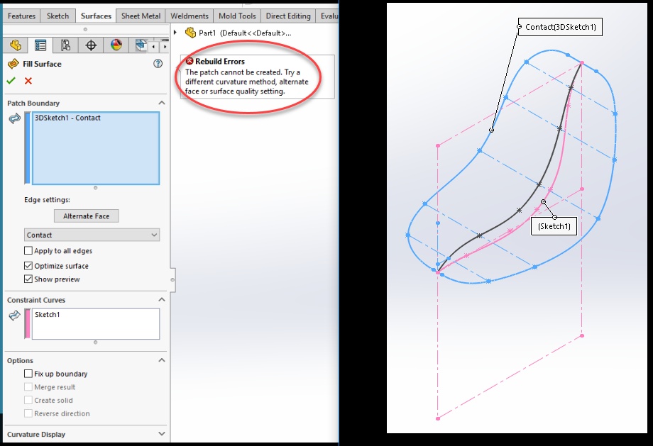

fyi... if you are sharing sketch data, you will need to use IGES (the STEP export does not support sketches, see link)
MN
MN2017-12-17
It dose not work.
Parasolid also does not work.

Try this Paul..
DB
DB2017-12-17
Maha,,, I did create a new 3d sketch for the periphery. Edit:.. this is off the iges I sent. It's all in the export/import options.

..make sure you have checked your iges export options to include sketches.. (btw, Dennis sent a iges)
PS
PS2017-12-17
..thnx!... yeah, it's seems to work ok?...but, I'm sure there is something...?

Try apply to all edges in your original file.
Edit:.. Ooops. looks like I got the wrong Constraint Curve. My Bad.
DB
DB2017-12-17
Paul,, are you importing as Curves?.. If you do you get this.

I created two new sketches on the periphery it worked. I do not know why.
DB
DB2017-12-17
I think the issue is a result of such a drastic change from your 3d sketch and your sketch1. I changed it to this.
That works but you probably need to do some more alteration.

.. I did not.. had sketches on... ok... yeah, seems to work fine..

With sketch1 it gave me an odd shape by using convert entity and placing another sketch over sketch1 which is sketch6 I got a correct shape.

Well,, I'll be darned.. That does work fine on the iges. Doesn't in Maha's part file. Curious,, how did you get the mesh to extend beyond the curves? What is that?

Are you able to find out why original sketches do not work but convert entity works?
DB
DB2017-12-18
No, I can't figure that out. I checked out the curvature combs in the original sketch and the converted. Both ways look identical. I am blown away with how well the iges file works though. Would be nice to figure this out.
Edit:... Interesting. Make your curves composite curves and it works very well.

Randomly I made another model. It came without any problem.
