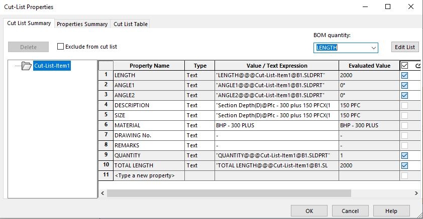

I'm trying to create a template for parts and drawings where we have structural members drawn as a part, and assembled with each other as an entire job.
I am unable to carry over the size of the structural member, although I can see it in the weldment cut list, I can't get the property linked to it.
I have tried every combination of \\\$PRP to no avail.
Below is a screenshot of an example of a weldment cut list in a part drawn using a structural member profile.
Below is a screenshot of the File Properties that I believe I need to get the correct properties into, in both the summary and configurations.
This is the result I'm currently getting, where the blank spaces should show the size of steel profile I've used for the structural member.
Specifically, they should read "150 PFC"  and "90x90x3.5 SHS", respectively.
Can anybody help, as I've read absolutely everything I can find on the subject.

RE 2021-04-08 Best Answer
Hi Sam
If you tick Detailed Cut List then you can access any of your cutlist properties in the BOM
comment imagecomment image

I also should note that my goal is to make all of my parts single body features, that are all assembled into an assembly.
This allows me to utilise a library of standard parts that will also be populated in the Bill of Materials.
SL
SL 2021-04-08
Rob,
Unfortunately, the detailed cut list gives me information that I don't want to use, since I can't control how it's coming out, it becomes a mess.
I want to be able to get some of the data is offers, like the description, but be able to access is it in the File Properties of the individual parts, so I can then save that as a part file template to populate my Bill of Materials as "Parts Only".
