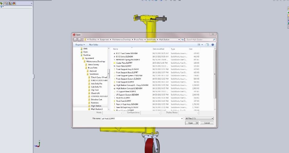

When I open certain parts or assemblies, the file-open window pops back up and won't close.  As I click the close button, it appears to run through the parts associated with the file, but the names are partially hidden in the file name box.  After enough clicking the close button, the part or assembly completely goes away, or parts within it disappears.  Something seems corrupted.  Anyone else have this problem?  Using SW2012.

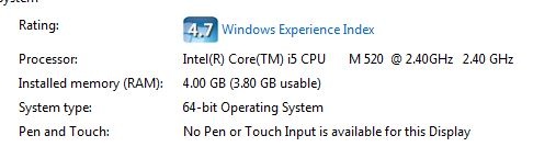

It sounds like a resource problem - please tell us something about your system - RAM, Graphics Card, etc.

actually sounds more like missing or broken file references to me.
can we get screenshots?

Basic details.....using Intel HD graphics

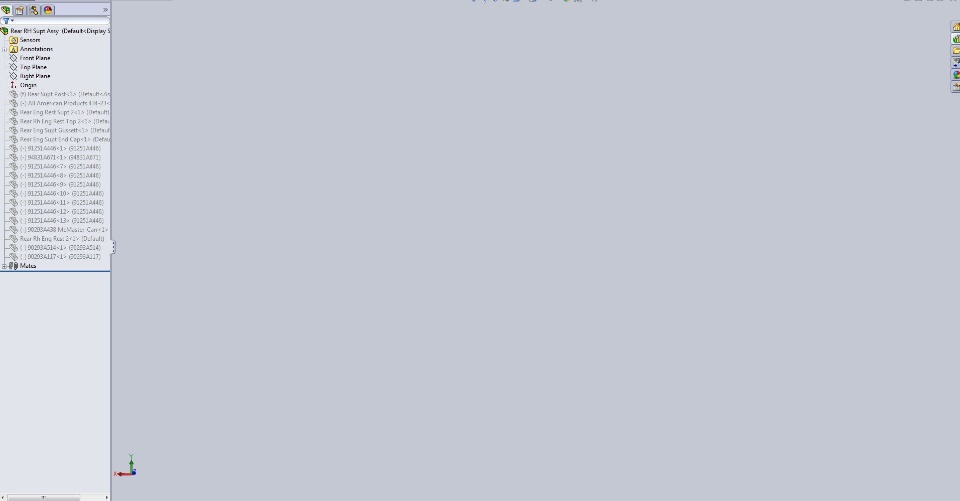

I think it may be trying to pull up all reference files.....if I keep clicking to close the window, eventually the part or assembly disappears, and all the features in the design tree are greyed out.
