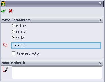

Ok, we have Part files with any number of Configurations.
On each configuration there is a need for certain text to be shown on the part, replicating a stamping or engraving.
Is the a file size savings between having (25) Extrude Cuts for the different text required vs. (25) Wraps with the Scribe Option?
In each instance we would have a maximum of (3) characters per feature.
Would there be any noticible difference or would it basically be a wash?

Without testing i would say that the wrap feature would increase file size more.
CC
CC 2010-07-22
I am going to disagree with Greg.
Scribing text with the wrap tool should decrease file size (probably).
It will definitely decrease rebuild times.
Creating the edges of the extrude, as well as calculating the end conditions will take extra rebuild time. It also builds additional faces that have to be saved with the model, which will also increase file size. So that is what I would expect. Does the "wrap" tool in general take more space than extrudes? I don't know.
Another question though, why are you comparing extrude-cut vs wrap with scribe? Extrude-cut is for flat faces, while wrap is for cylindrical/conical. If you want to "scribe" onto a flat surface, use the Insert>Curve>Split line tool to create the engraving. If you want to extrude on a cylinder use the wrap>de-boss option.

  FWIW I just had to put markings on a part and looking at the feature stats for my text of two rows of numbers in the format:  ##-#####
Wrap Feature: 3.84 (s) (deboss 0.1 depth)
Cut Extrude:    1.13 (s) (0.1 depth)
I can't use split line or scribing because I need the text in my non-shaded drawing. But just to see what it would be I did them anyway:
my scribe option for wrap was 3.59 (s) and 1.49 (s) for a split line
so it looks like a Cut Extrude in this case wins for rebuild times.

Looking at feature statisics on a legacy part (Extrude Cut) and a "fresh" part (Wrap), I have to agree with your findings.
The Extrude Cut vs. the Wrap feature
Extrude Cut 42.47percent .09 sec               Wrap 39.49 percent .20 sec
Main Sketch 21.46 percent .05 sec             Main Sketch 18.09 percent .09 sec
______________________________            ______________________________
                    63.93 percent .14 sec                                57.58 percent .29 sec.
So the Exturde Cut in this case is a higher percent than the Wrap, it is also more than twice as quick. The Exturde Cut part has 61 features and a total rebuild time of .22 seconds, while the Wrap part has only 36 features and a rebuild time of .51 seconds.
Opposite of what I would have expected really.

Let me clarify my statement too. You both are comparing wrap+deboss with extrude-cut. I will agree that wrap+deboss will take longer to rebuild. My statement is that wrap+scribe will theoretically cause a much quicker rebuild. I suggest testing that on your actual part for a comparison.
SF
SF 2010-07-26
Charles,
The times shown in the stats above are a Wrap Scribe as stated in the initial post.
<p></p><p>Is the a file size savings between having (25) Extrude Cuts for the  different text required vs. (25) Wraps with the Scribe Option?</p>
Is there another way to test the rebuild time?
Wrap - Deboss times shown below.
