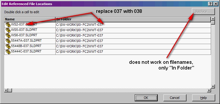

So I am trying to do a Find -> Replace all on When doing a File->Open->References on a drawing.  Say all of my old parts have a -044 suffix on them and my new models have a -045.  I want the drawing to see the new files with -045.  The Find->Replace all does not work in the Referneces dialo
Anyone know another way of doing this, possibly with a macro?
BTW, I know that Pack&Go is suppose to do this, but there is a bug which locks up SolidWorks when clicking "Include Drawings".  I am trying to find another solution rather than manually relinking the new models to the drawings.
SEE SCREENSHOT BELOW

Have you tried using Solidworks Explorer to do this?

SW Explorer doesnt even have a Replace All option, you have to manually click on each file in a drawing and map it to a new model.  Big PITA when you have 20+ parts on each drawing

Agreed, but it is the only thing I can think of.  Don't know of a global replace all function.
Unless like mentioned before you write a macro.

For the drawings, I think you'll have to do one at a time.

I am still seeing this behavior in SW2011 SP3. The repeatedly clicking the Replace button works, but the Replace All does nothing.

In my experience "Include Drawings" in Pack&Go can be really really slow finding the drawings, but is does work.  I don't recall using Find/Replace with Pack&Go but it is pretty versatile.  You might want to try it again and just give it more time than you think it needs, (go to lunch) and see what happens.
