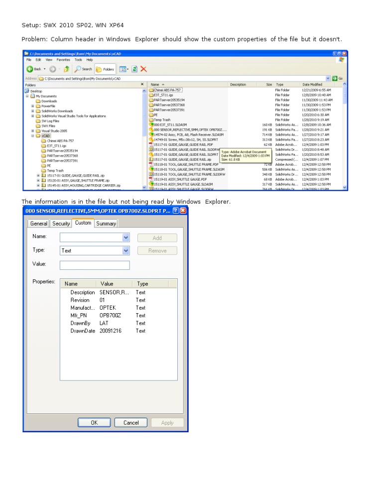

File Property "Description" does not show in Windows Explorer column
Setup: SWX 2010 SP02, WIN XP64
Problem: Column header in Windows Explorer should show the custom  properties of the file but it doesn't.
The information is in the file but not being read by Windows Explorer.

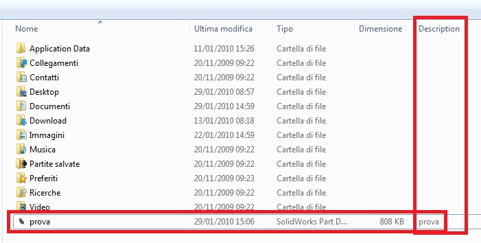

For me works fine.
Try to add a column, because this description is the 'summary description' and not the SW file description property.

Hi, it works fine for me in both XP and W7.
Try going to SW options/general and set which ever custom property you want to be considered "description" by windows explorer.
