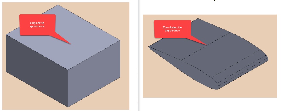

Some times it is impossible to convert downloaded file to my desired file appearance. What is the reason for that?
I noticed sometimes the appearance is applied on every single face. In that case I use the command 'Remove All Part Appearance'
Also lights are turned off:
The part is driven by design table:
The other part don't have material assigned.
Reapply material for both and rotate them to same view:
SW does have problem with appearance.
White part became grey after I add a config.

Is it a surface body?
It does not work.
Try switch to different material and switch back.
This is what I can see in my file.
Isn't that just lighting ?
I tried this before but it didn't work.
Delete all appearance and re-apply material.
Also make sure thy use same scene and lights.
