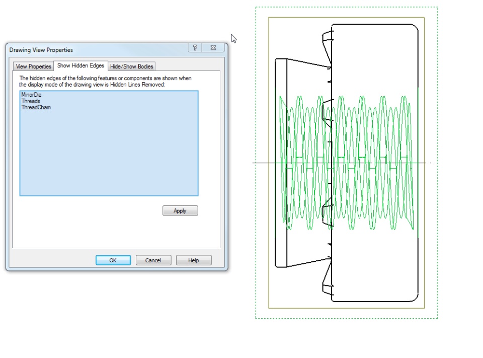

Maybe one of you can enlighten me as to why this is not working. I am trying to show some features as hidden lines in a view. I just want some features to show as hidden, not the entire part. I have selected these features that I want as hidden lines in the Drawing View Properties box under the "Show Hidden Edges" tab (see attached JPEG). I hit Apply then OK. The view does not have the hidden lines like I wanted. The display style for this view is set at "Hidden Lines Removed". What might I be doing wrong here? Thanks in advance...
FYI, I am using SolidWorks Premium 2011 x64  SP 5.0

Try right clicking on that feature in the feature manager tree and select Show/Hide > Show Hidden Edges.

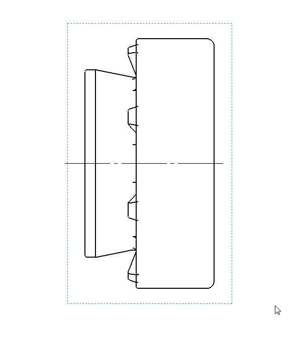

Deepak, I have attempted your suggestion but the features appear to already set as "Show" as it only gives me the option to select "Hide Hidden Edges"  (see image).
comment imagecomment image
AS
AS 2011-11-15
It looks like I resolved this problem! This model has multiple bodies in it. I went back to the model and set the feature scope of these features to "Auto-select" instead of selected features. Once I did that, the features showed as hidden in the view that I wanted. Thanks for your help Deepak..
