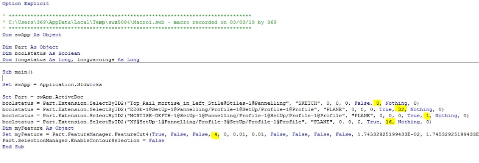

I was struggling to work out what Marks I should apply to my selections as I didn't see anything in the help
2018 SOLIDWORKS API Help - FeatureCut4 Method (IFeatureManager)
..so I used the macro recorder.
The macro recorder gives me marks of
0 for the Sketch
32 for the From
1 for the Up To
16 for the Direction
and a value of 4 for T1

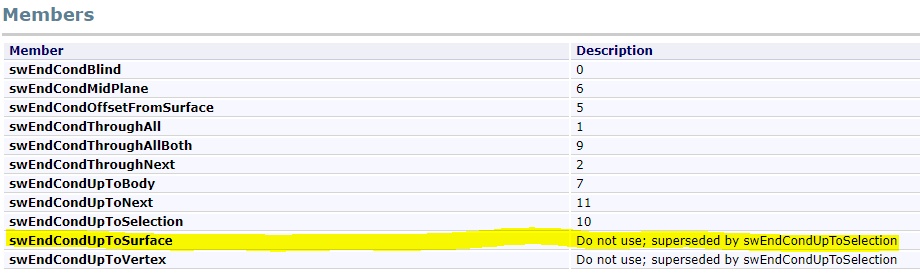

What's strange is there is no 4 in the helpfile I presume it's the obsolete swEndCondUpToSurface
2018 SOLIDWORKS API Help - swEndConditions_e Enumeration

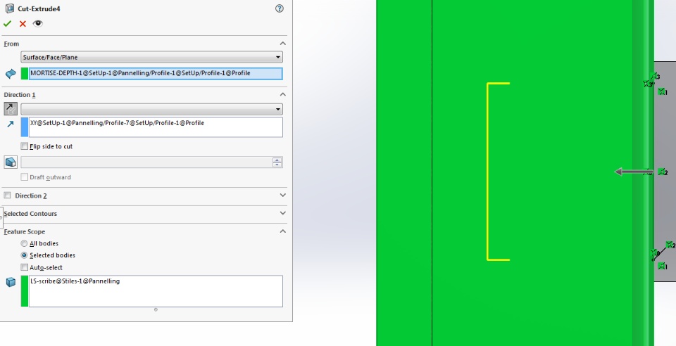

When I use swEndCondUpToSelection as recommended the feature gets created but is incorrect, with my end condition becoming my start condition
and the Direction1 ComboBox is empty!

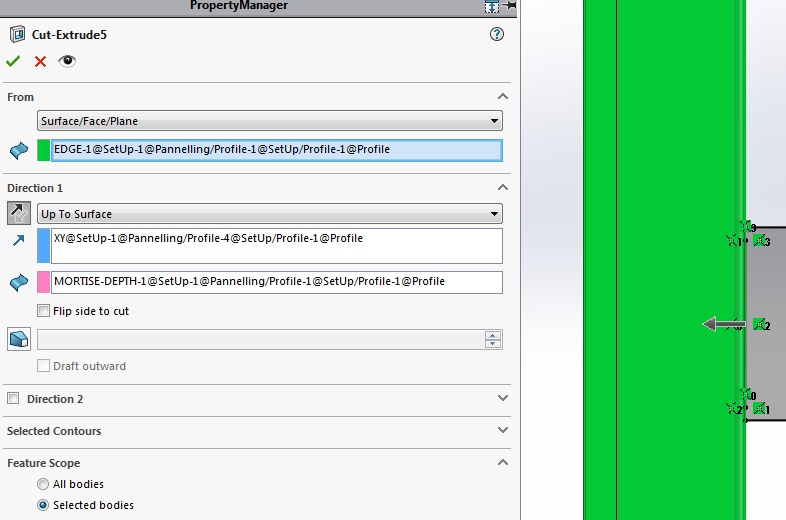

It works fine if I use what the help file tells me not to use.
4
Am I wrong or is the help wrong?
What's the secret to knowing what Marks you should use?
