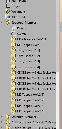

When I have a feature expanded within the feature tree, moving the scroll wheel makes the tree view scroll up and down.
When no feature is expanded (possibly = when the whole feature tree is visible on the screen, I'm not certain), moving the scroll wheel makes the tree view scroll left and right.

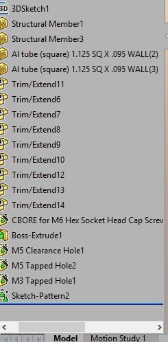

There are two ways to keep it from scrolling left to right.  Both of them result in the same thing.
Basically, in order to prevent it from scrolling left to right, you need to either:
1) expand your feature tree to the right until all text is shown
or
2) minimize the amount of text shown so that it doesn't extend past the limits of the feature tree.
for way 1, this is simple:
Just grab the right edge of the feature tree window and drag to the right until all text is shown:
for way 2, uncheck some of the things here to limit the amount of text displayed in the feature tree:
