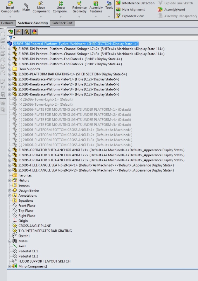

Hi, for some reason, my Feature Tree has decided to turn upside down.  I usually have "Favorites, History, Sensors, Design Binder....Front, Right and Top planes on top and my assemblies and parts below that followed by Linear and Mirrored patterns.  I've attached what it looks like.  I've tried dragging and dropping the assemblies below and tried dragging and dropping the Favorites, History, etc above to no avail.  I've also tried doing a pack and go but that didn't work either.  This is the only assembly this has happened on.  Has anyone else experienced this?  Is there a way to fix it?  Any help would be much appreciated.
Thanks,
Verne
SolidworksAssemblies

I had the same problem back in May, and earlier this week. I submitted the earlier file to my VAR and they forwarded to SW. They determined the file was not corrupt, but could not find the cause of the problem.
Luckily I found a workaround...
I inserted a new component into the assy and noticed it was placed correctly below the origin. Once there, the other components could be dragged down below the new one. The new component could then be deleted and the assy was fine again.
Hope that works for you also. Good luck.
You should also ZIP all the files & submit to your VAR as a glitch.

Thank you very much Kevin.  That worked!  Was driving me crazy.
