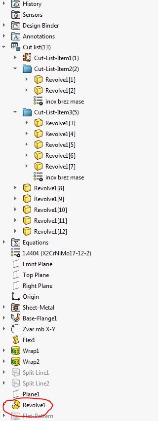

is it possible to exclude mass of specific features that generate bodies?
I've been trying to set custom material with 0 mass to this bodies, but the feature can make custom number of bodies and it's equation driven and new bodies don't inherit this material.
I've also tried using surfaces, but there are problems with section-cut in drawings because it doesn't cut surfaces.
This feature is only to enhance visual properties of the part... but I don't need extra mass!

Everything is OK with surface section in drawing
About assigning mass to the bodies generated by some feature - NO, you can assign zero density material only to body, not to the feature. At the same time you can assign mass of your whole part in design table by means of $SW-Mass column

look.
Broken-out section doesn't section surfaces and there is no option surface bodies.
comment imagecomment imagecomment imagecomment image

Make whole section and crop it

I know it's a working solution, but that would saturate my drawing views with needless lines... I assume this should go to to solidworks enhancment request...
