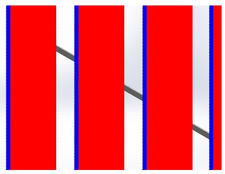

FEA Report Image Glitch
All of our model images are coming out like this when we run our FEA Report. Any ideas what would cause this? Thanks in advance.

EP 2017-05-24 Best Answer
UPDATE - Tried installing the latest video card diver, still doing it.
SOLIDWORKS 2016 SP. 5

TE 2017-10-27
I am having the same issue on approximately half of my report images.  Did you figure out a fix?
TH
TH 2017-12-05
Open a file in Solidworks and select save as jpeg.
Select : Options
Set to Print capture
change DPI setting in Print capture options to 50
Set to Screen capture
Select OK
This worked for me.
