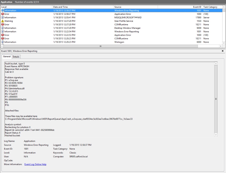

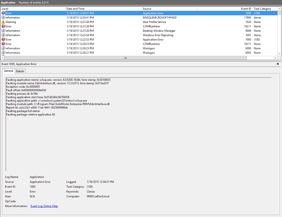

3) An application error is experienced (confirmed via. Windows Event Viewer - see attachment for screenshot of details).
4) A Windows Error Reporting event is wrote (confirmed via. Windows Event Viewer - see attachment for screenshot of details).
The issue must have something to do with the opening of SolidWorks as that is the last log that is wrote from our system; please note in the majority of cases (85% of the time) we experience no issues.
Core question - is there any logging provided by the SolidWorks API or associated components? I have these events noting that w3wp.exe crashed due to a faulting module EdmInterface.dll. Is there anywhere I can find why the EdmInterface.dll module has failed? Have I made an invalid API call, passed an invalid parameter, etc.?
