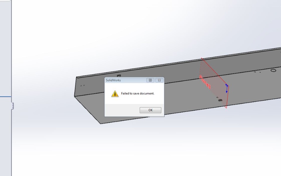

I used to get this error a lot and here are the things that contributed to it and the solutions
1) 32bit memory limitations-Windows XP, Vista and 7 32-bit versions can only address 4Gb of data and only 2Gb for each process-and that includes your video card memory, so if your solidworks process is hitting 1.4Gb of memory usage, you're close to getting this error. Getting a computer with a 64bit processor and version of Windows reduced occurence of these errors significantly.
2) Pulling files across a slow network: If you are opening files right off of your server and you don't have a robust dedicated fibre network with high-speed switches, you're going to have collisions and packet losses that will cause solidworks to lose posession of the file. In our case, the solution was PDM-where the files served to your workstation and edited locally.
3) corrupt models and drawings: Models that have become corrupted (which usually happens because of the first two circumstances) can crash solidworks, throw a 'failed to save' message and even prevent other open files from saving. When the behavior is related to having one file loaded in memory-either in it's own window or as part of an assembly, you've got what's called an acid part. Sometimes you can recover them on your own, sometimes you can get help from your VAR and SW and sometimes you're out of luck. It does suck, but fortunately it's rare. There have been some issues with Virus scanners damaging SolidWorks files (one because of the embedded JPG that's used for the preview) but that doesn't happen too often nowadays.

We had this happening with one of our SWorks users. He was working from on our corporate network. Since he started working off his computer, the instances have reduced greatly.
This may not be your problem. it would be easier for us to provide help if you could give us more info on what your are experiencing and when.

OK, Gary, let's see if we can isolate the network connection as the culprit (could be a bad nec card, cable, switch or you could be on a subnet with 10 guys streaming Hulu)
Use SolidWorks explorer to copy a data set to your machine and work on it as you normally would. If the instances of 'Failed to Save' reduce dramatically, then you can say that the network connection is a factor.

I think the issue comes about when i bring in a lance form tool the design libary. With the lance in the tree i cant save, delete the feature and i can save it !!! The lance form tool has been created by us internally.
As temp fix i am having to put the feature in within the assembly window.
Thanks again.

ok...only thing i can say about this is that there could be someone else on the network with access to that file that has it open in edrawings or viewer...
also if it is being utilized in a CAM software, there is probably a conflict with someone else looking at the file.
also, you can check the lance file...open the lance form, use ctrl-Q, then resave the lance. then go back to the part and try to save.

Have you tried unchecking the Link to form tool option?

Kelvin where do i find the 'link to form tool' uncheck box please ?
Set up a local copy of my work and fingers crossed it seems to be working OK.

I get this when I've been working with large assemblies and more often loose access to my network drive when doing drawings of said assemblies. I've putting it down to some sort of network issue in my little brain. The failed files will allow you to save to a local drive successfully, which can be good if you've done a lot of work, but creates more work in getting them all back in the right place and refernced properly.
