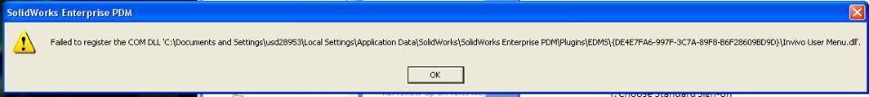

Failed to register the COM DLL .... custom Addin that we use
OK - I have sucessfully installed ePDM on 300 machines- This is a new error  when installing to an XP box. I verifed the Version and SP of the client.
Completely stumped. Is there a way to "Manually" register?
Thanks much
Scott

Have a look at regsvr32. Your error probably has something to do with permissions. (Limited user maybe?)
