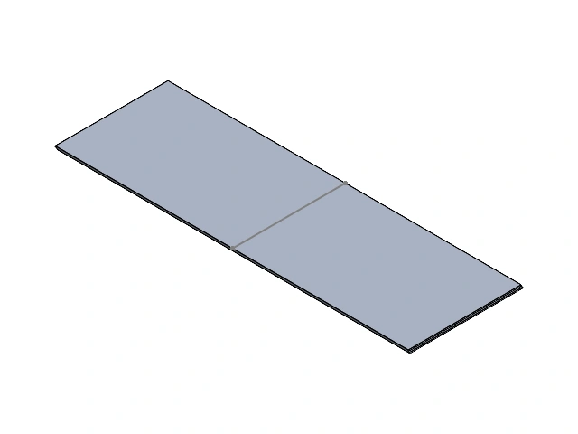

Hi,

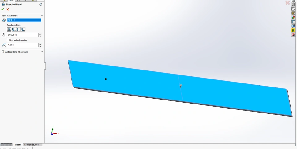

I am trying to create a cylinder from a flat part using the Sketched Bend feature. Conceptually, to make a sketch bend, I created a sketch line in the middle of the sheet and selected the face. However, Solidworks gives me the "Failed to make the Sketched Bend" rebuild error. I am running 2022 SP5.0 version.
To prove the bend, I have kept the bend at 90deg rather than 359deg like you would for a cylinder. I have tried to increase the bend radius but that has not worked either. For reference, the sheet is 0.25in thick. Screenshot below. File attached.

Use and open profile for your base flange. draw and arc to the correct dimension and leave the ends of the arc a small amount apart. then extrude your base flange. I have found over the years that you should try to draw your finished form and let Solidworks un-fold the part instead of the other way around.

the cut extrudes seem to cause the problem, solidworks seems to like equal thickness all the way, if you suppress them, it works.  If you move them after the "process-bends" it also works
