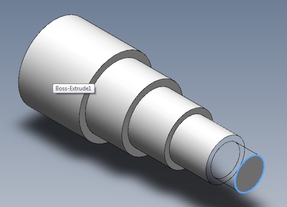

This problem came up a few days ago and I was not able to find a solution:
I was working my asseblies and parts when everytime I move my mouse around, random parts and faces within the assembly would disappear and reappear as I work. It is quite annoying to say the least.
Here is a picture of what I am talking about:
Before anybody asks:
I'm using a MSI GT660 Gaming Laptop with Intel's Core i7-740QM CPU with NVIDIA's Geforce GTX 285M GPU and a Ram of 6GB. I should not have any hardware issues as I'm concerned.
This is also on Solidworks 2010 SP0.0
Is there anyway to fix the disappearing faces issue?

If you adjust the image quality does it make any differenace? Also, do you get the same results if you change display style?

go to tools>options>document properties> image quality>slider at the top.

Now this is odd:
Solidworks decided that this time, it will work as intended. So no more disappearing faces.
But as a preventative measure, what should I do to make sure this will not happen again?

But as a preventative measure, what should I do to make sure this will not happen again?     <br>
Simple ... Get a sytem with an approved video card. All the time you are running that card you run the risk of seeing graphics anomalies such as you describe. If or when yu upgrade SW, those anomalies will probably become more frequent and be more severe. Read the link posted by Timothy.
An alternative is to search for a "soft-mod" utility which  "converts" your card to an approved version. The driver for that version can then be used.

yeap in all the years i have done support on solidworks i have seen the video card be the cause of the issue dozens and dozens of times.  i know people hate it when i tell them that but it is what it is.  I use an ati radeon card on my personal laptop and know that it is not approved so no real view and praphics issues from time to time are just things to live with.  as kelvin mentioned sometimes there are things you can do to try and work around it. some of these have worked for me and others have not.
