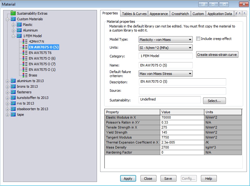

The material for the shaft is set on Plasticity Von Mises with Etan set on: 75500 MPa (A higher value as the Emod. otherwise I
get this error: "Incremental plastic strain is too large"
I guess the Etan has to be around 10% of the Emod but I'm not sure.

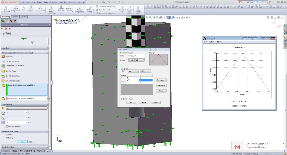

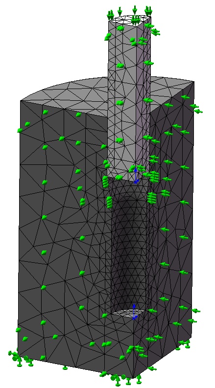

For contact set I've selected the outside of the shaft and the inside of the die. (No friction)
Advanced contact settigs: Surface to Surface
The bottom of the die is Fixed.
Both Planes are set to symmetry fixtures.
The shaft has a diplacement downwards of 6.4 mm so the top planes of both parts will be equal.
I've set up a time curve this way:
When the displacement is returned to it's origin I would like that the part is still deformed.

I've created a coarse mesh with a mesh control on the outside of the shaft and the inside of the die.

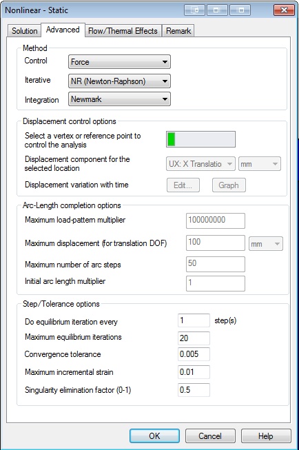

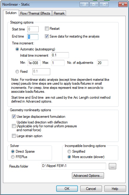

These are the settings I've used in the study properties:

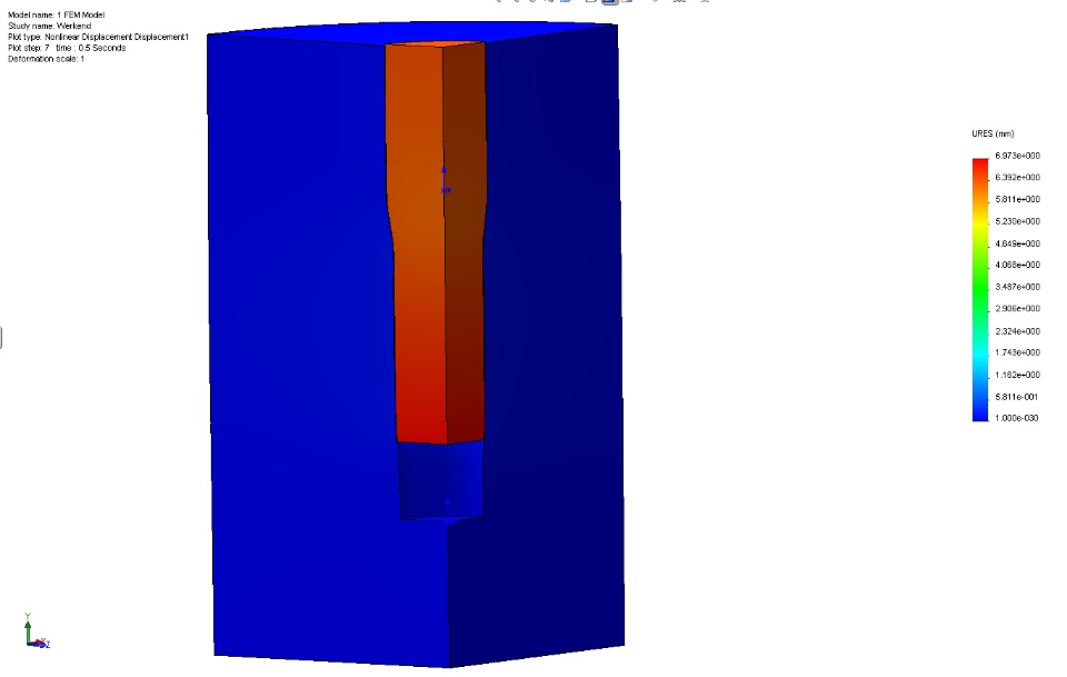

Results:
The volume of the shaft is the same as the open volume in the die so I don't understand why the shaft don't fill up the die.
I understand that the die will deforme a bit as I can see when I plot the displacement in Z. But that isn't that much.

Setup sounds ok to me
Is the contact actually happening? When you hide the block can you see it compressing?
Also, why not do this as 2d axisymmetric?
The model looks simple and non proprietary enough to post here. Best next step I think.

when you look at the results are the components overlapping or are they touching face to face? it is hard to tell in that screenshot
also, just to double check, you might want to check that your volumes are exactly the same.
SF
SF 2013-12-04
The components aren't overlapping as you can see:
There's just a slight difference in the volume before and after (0.08%).

Also I'm still in doubt about the Tangent Modulus. The solver only completes when I use
a Etan higher than the Ex. I think this value has to be about 10-20% of the Ex. But when I
try to solve with this value I keep getting the warning: "Incremental plastic strain is too large"

SF 2013-12-09
I've made some progression in the last days.
I have valid material specifications.
Now using CuZn37Pb2.
E-modulus:           105 GPa
Poisson ratio:        0,35
Tensile strength:    370 MPa
Yield strength:       180 MPa
Etan:                    1100 MPa (about 10% of E: https://forum.solidworks.com/thread/39599)
Using a poisson ratio of (near) 0.5, than the material will act as rubber.
Although the study was not completed (85,3 %), the results are better than before, because now the material flowed.
