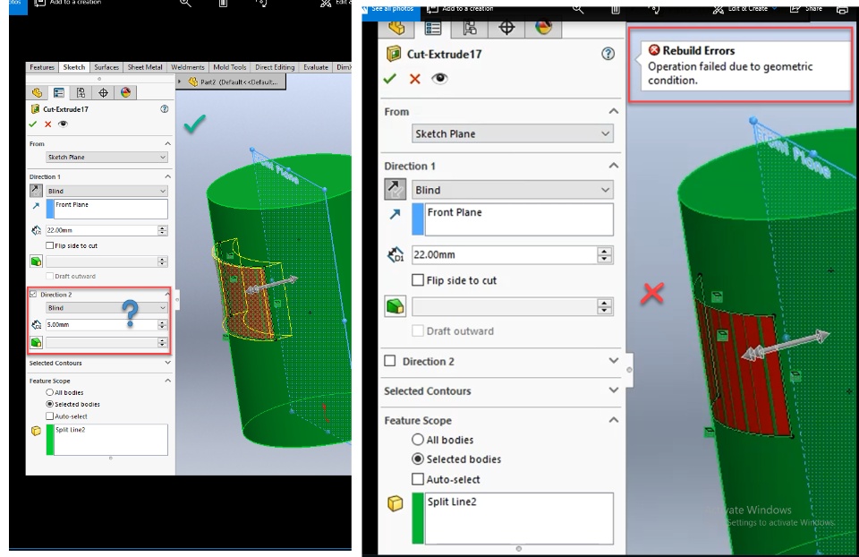

There are two separate solid bodied red and gray one. Red one is interfering with gray one so that I want to remove some of the material in gray one interfering portion by extrude cut. But extrude cut require two direction to work otherwise it produces error message. What is reason for that?

That could be because of ZTG ("Zero Thickness Geometry" ).
Make a copy of that surface and do a thicken cut of 22mm.
comment imagecomment image

My guess is that you are using geometry from the "red" body to cut from the "gray" body.   When 2 surfaces from different bodies line up and you want to make a cut to body 1 from geometry from body 2, it is almost always a best practice to extend the cut outside body 1.  If you were using geometry straight from Body 1 instead, you would probably not get this error.

Thicken cut can’t be an option because I want to retain both bodies. Which is the location of ZTG? Because minimum 5mm cut is required in direction2 for cut is to happen.

<p>Maha Nadarasa wrote:</p><p></p><p><span style="font-size: 12.0pt; font-family: 'Verdana',sans-serif;">Thicken cut can’t be an option because I want to retain both bodies. </span></p>
You can select the body you want to cut with thicken cut. If you see my screen shot above, the red body is hidden.

If you want both body you must
Knit surface
Surface cut
Hide Knit
And that's all both bodies

I'd suggest using the Indent feature instead of the Extruded Cut.
comment imagecomment imagecomment imagecomment image

Thanks for reminding about that underused tool.
