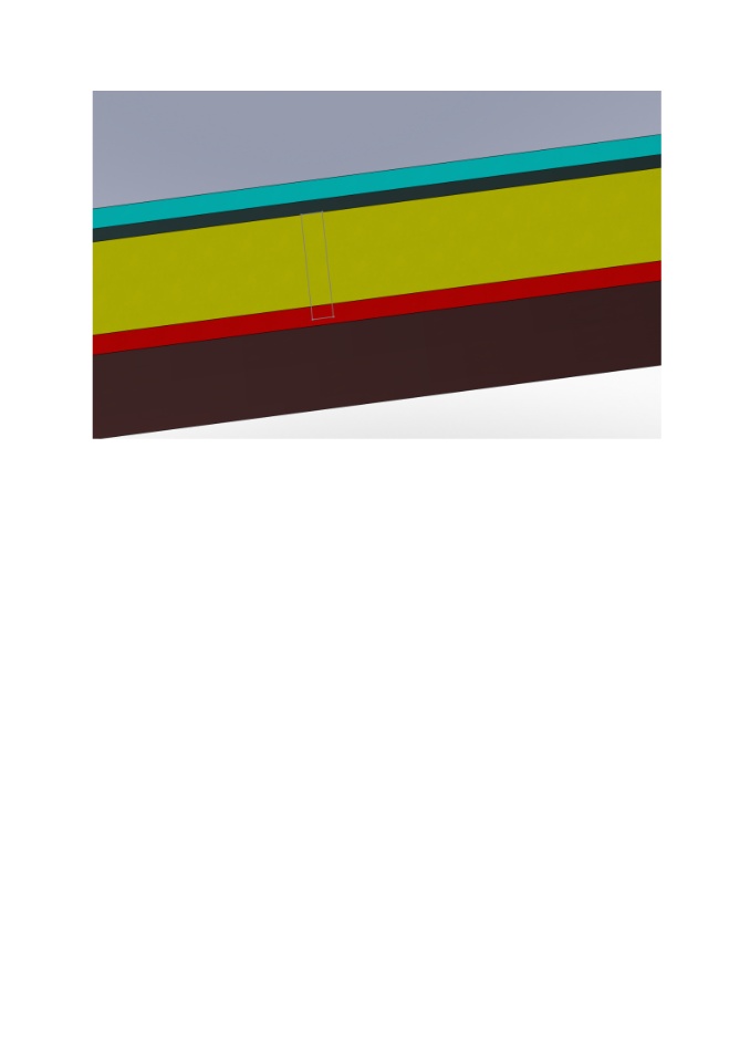

Hi,
I have an assembly where I want to add a stiffener on the outside of one web face.
So with the assembly open i go insert -- create -- new part.
I then select a face to sketch on and sketch the stiffener width, I then dimension so it's in correct position.
I now want to extrude this sketch so the height is flush with the top of the red flange (125mm).
However when I go to Assembly features there is no Extrude option, only extrude cut, holes etc.
My question is how do I extrude a sketch to create a new part while in an assembly.
Attached a screen shot of what I am trying to do.
This is first time i've tried this usualy parts are created before assembly.
Thanks
Mark (SolidWorks 2010 SP1

MA 2009-12-16 Best Answer
Mark,
Assembly features only allow you to remove material.  If you want to add material, you'll have to do it in a part.  Either add material to an existing part, or you can insert a new part.  What you're looking to do could be accomplished by first selecting Insert>Component>New Part.  You can then extrude a sketch up to a surface.  Although, in this case it seems overkill to use in context modeling for such simple geometry.

Mark are you still in part edit mode as I can't guess it from the snap shot you have uploaded.  I guess you have existed out of part mode and switched to assy mode.

You are correct I created sketch on face in Part edit mode then exited out back into assembly mode to try and extrude.
Mark
MG
MG 2009-12-16
Hi Deepak,
Just realized why you asked if I was still in Part edit mode, this is where I should have been doing my extrusion and not in the Assembly mode.
thanks both your help all good now
