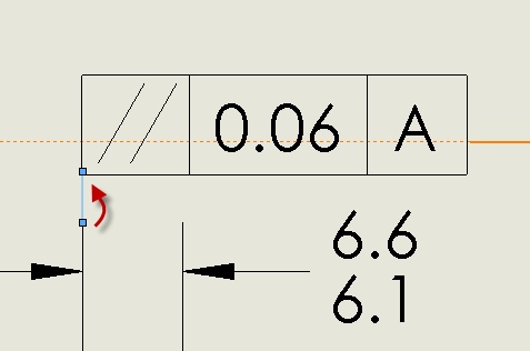

Is there a way to extend a dimension extension line on only one side? (the ending overhang, not the geometry connection end)
Ideally the Feature Control Frame would be connected to the extension and move with the view.
not that i know of.
the proper way to get what you are looking for is to attach the FCF to the model edge on that side of the dim (since that is the face it is controlling) and then drag the FCF out past the dim. the leader for the FCF will lay on top of the extension line.
OK, I got it, but I was trying to "attach to model edge" and it actually attached to the extension line. Then when I dragged it out the extension line stretched.
For others who find this through search.
After getting the frame attached to the extension line - drag frame (green arrow) not the connection point.
