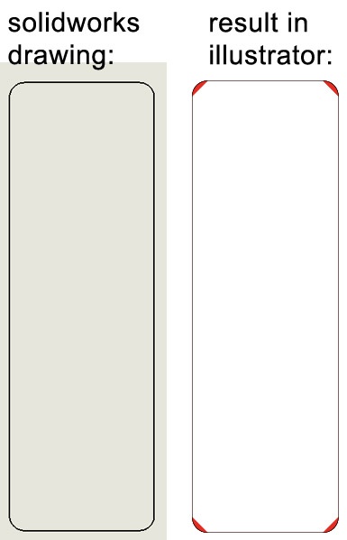

i have a logo i made in solidworks. now i want to move it to illustrator so i can send the file as a clean filled graphics with no outline (or stroke, in illustrator i guess) to the client.
anyway, its just a few very basic shapes with fillets.
then i export them to DXF or illustrator files from the drawing.
but when i try to get a closed shape, filled with color inside illustrator, i get color only in the corners.
i cant seem to figure what the problem is.
here is a part of the graphics, in the drawing, and after i try to fill it in illustrator:
any ideas will be great.
i guess the illustrator doesn't recognize the square as a closed shape, and i dont know how to define it as a closed shape.
i have to admit that my illustrator skills are very bad and that is the cause of the problem, but i hope you guys can help me out to figure this on going problem that i have when exporting to illustrator.
thanks in advance,
joel

Hey joel,
there are some settings when you go save as DXF click on options and change to polylines play with each of those to see if that helps.
if not.
when you are in illustrator, box select the individual elements and hit CTRL+J
that will join your individual line elements into one object.

The Join command in Illustrator should make these a closed shape.

thanks chris,
for some reason the join command is about the only option i didnt try...
thanks a lot, you really helped me out.
