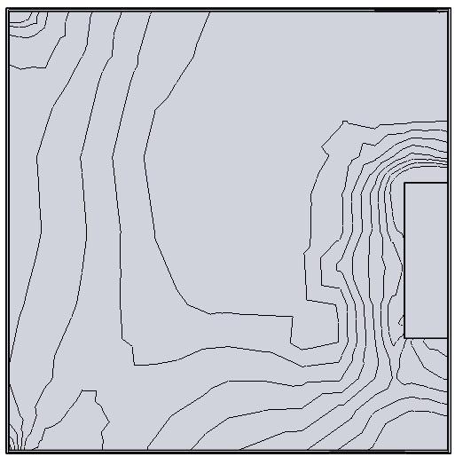

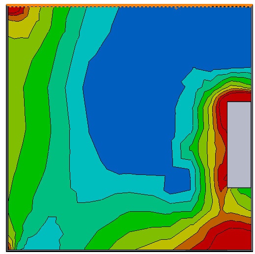

I read plenty of feeds regarding exporting of the model/ assembly file into vector format for high resolution (Saving as PDF of AI). But It seems we can't do such for the contour results. Saving image/ cropping all produced the pixelated image. I have the following 2D contour but I only want to export it's isolines in high resolution vector format to be editable in adobe illustrator. Is there a way? Please help
When I save it as pdf or ai file, the contour/ isolines disappeared

As far as I know, there is currently no way to export raw CFD data from the program. All post processing must be done within SolidWorks.  You can only export rasterized images. There may be third party tools that can do this, ask your VAR.
