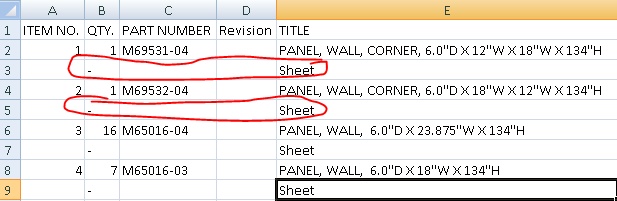

Hello Everybody,
Is there a way to change the code below so it doesn't export the sheet lines see picture
' choose bom type
Private Sub but_Export_Click()
    Const BOMTemplate As String = "C:\\....\\BOMS\\EXCEL BOM SORT.sldbomtbt"
    Dim OutputPath As String
    strUName = CreateObject("WScript.Network").UserName
    OutputPath = "C:\\Users\\" & strUName & "\\Desktop\\"
    Dim ConfigName As String
    Set swModel = swApp.ActiveDoc
   ConfigName = swModel.GetActiveConfiguration.Name
        Set swBomTable = swModel.Extension.InsertBomTable(BOMTemplate, 0, 0, swBomType_e.swBomType_PartsOnly, ConfigName)
    Set swTable = swBomTable
    swTable.SaveAsText OutputPath & "BOMTable_" & swModel.GetTitle() & strExt & ".xls", "" 'vbTab
    Set swAnn = swTable.GetAnnotation
    swAnn.Select3 False, Nothing
    swModel.EditDelete
    MsgBox ("All done. Excel document saved on your desktop."), vbInformation
End Sub
