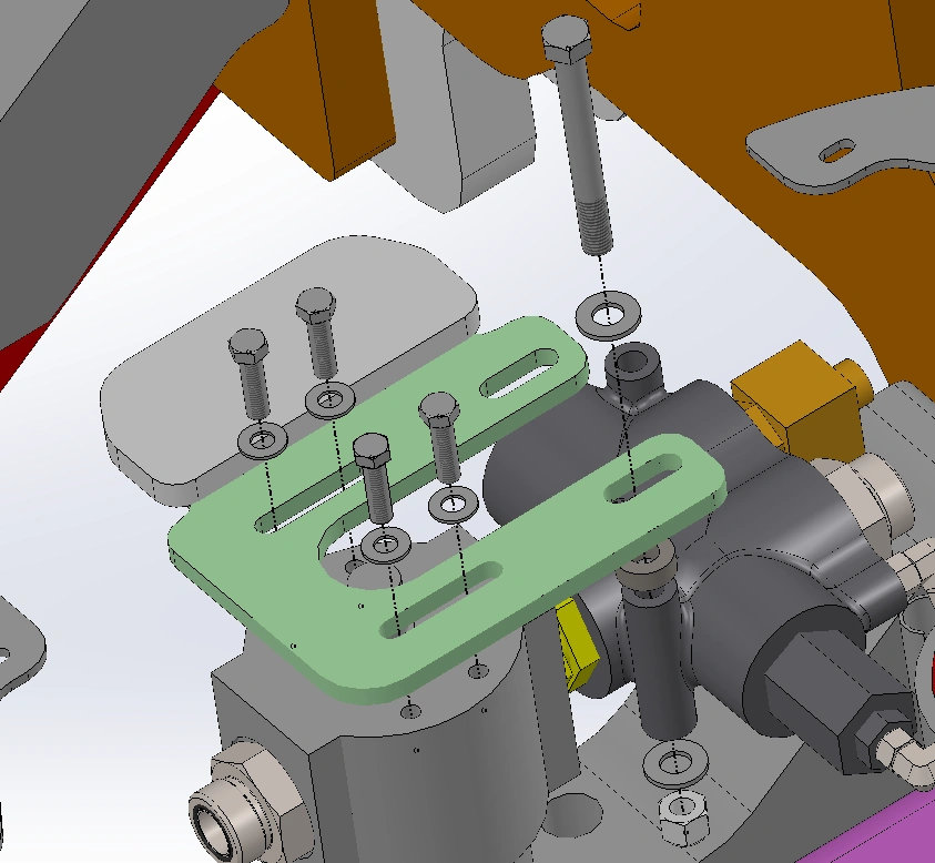

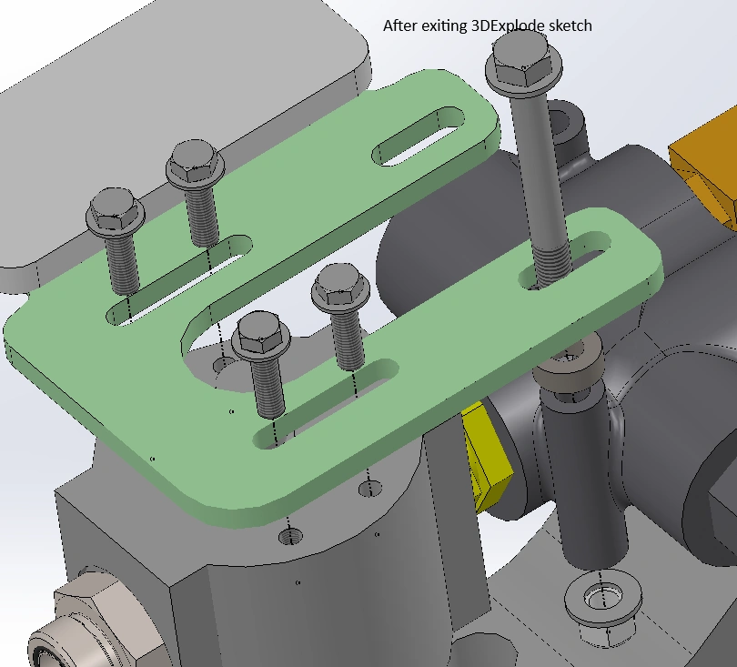

Since I'm on a roll this week, here's another little annoyance. After exiting a 3DExplode sketch, some of the exploded parts move to a less than desirable location. A CTRL-Q takes care of it, but...
Interesting tidbit - all the parts out of position after exiting the sketch have Profile Center mates.
you should try exploding a solid body and watch it move off the screen with each rebuild.
