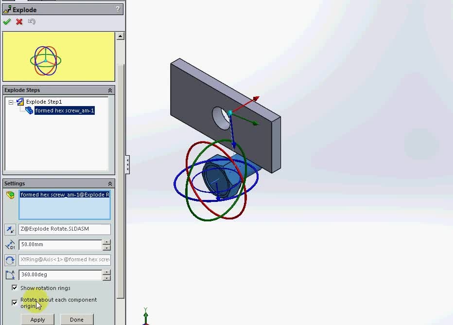

Hi! How do I change the rotation (left or right) with the new rotation feature in explode?
The window for the "Reverse direction" button is greyed out and nothing happens when I try to change direction.
You need to expand the explode step and select the component. Then uncheck "Rotate about each component origin" option.
