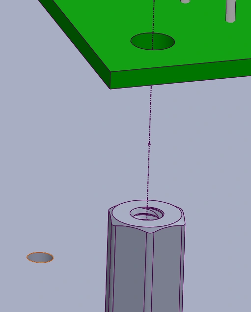

Good morning, when I create some explode line sketches, I notice that some explode lines have a slight jog in them. I presume this is because the centers of the parts are not exactly in the same location. For example the two holes on the PCB are 2.5512" apart and the holes in the baseplate are 2.55" apart. Is there anyway to have the explode line sketches look better without the jogs?

Only way I've found is to edit the explode sketch, delete the jogged lines (and one of the ones that passes through a hole centre), then extend the other hole-centreline up through the other part.

many of those jogs are based on what you selected.  The standoff has real threads, if the component was in line and you selected the un-interrupted chamfered edge on top it wouldn't have the jog.  You can also select the axis if need be, say on like a spring.   What Dave suggested is a simple solution if you have to trim away. It really boils down to fancy 3D assisted sketching.  I typically select all my components and then shut off the line tool and trim what I need and add back in any relations to the end points or lines.

I think that the exploded line sketch has a lot to do with how the exploded view was created and where you pick on the model to add those sketches.  If you are not picky and consistent with how this is done you may want to just sketch them in and add the relations you want to the sketches.
