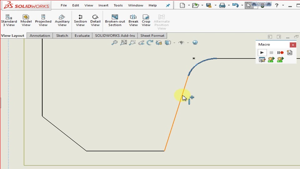

I am attempting to write a macro that will allow users to select lines on their drawings and then the lines will become bolded.
That part of the code is working great, however it just wont stop.  The macro keeps running and I cannot end it. I have included the text for users to check.
I do not know exactly what is happening here as this is my first time dealing with classes
