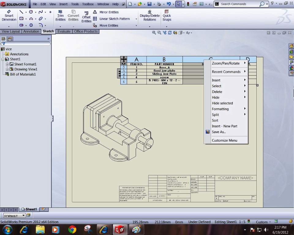

Step 1 :- Insert Bom Table Of your Assembly In Drawing.
Step:-2   As shown in Image 1 Right click on Above notaion eg  A,B,C....etc etc

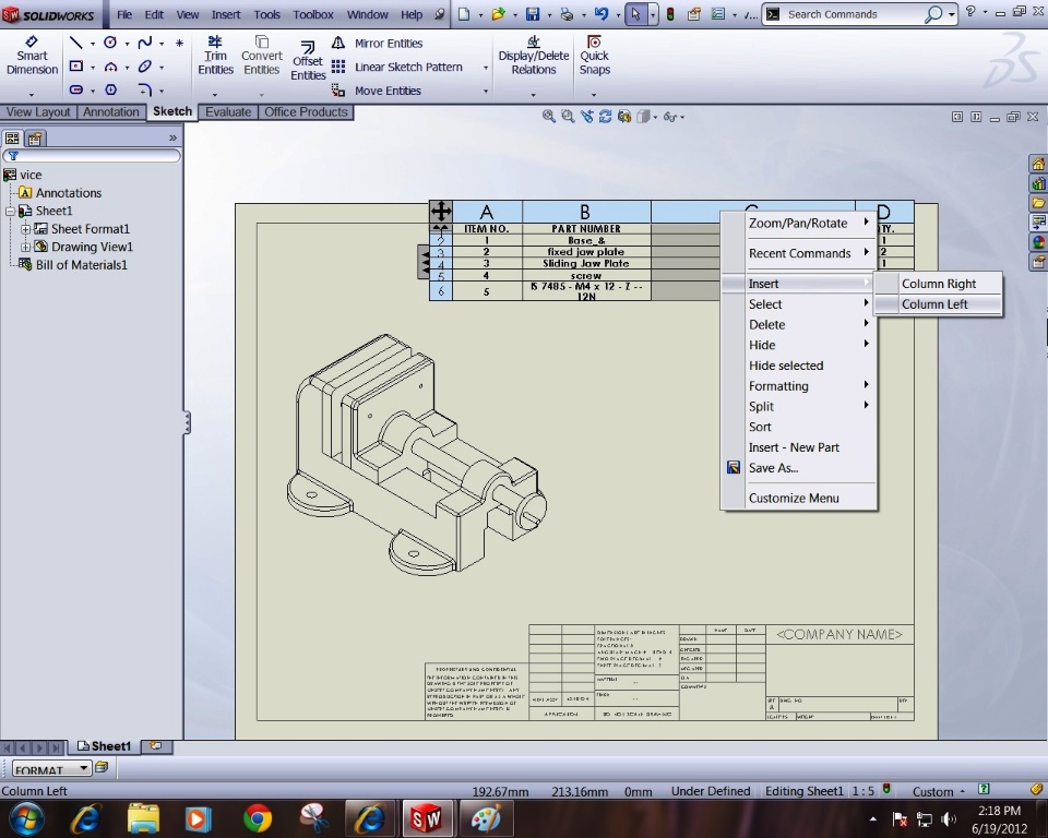

Step :-3  As shown in image 2 select which side you want your cloumn to be added right or left.
Step 4:- As shown in image select the custom property which you want to display in the new column.
