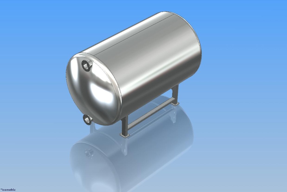

Example of Tank with Base - A Top-Down Main Assembly with two Subassemblies 100% parametric driven by user input table inside a DT and Ref_Geometry Part.
I posted a new version of this example assembly.  See https://forum.solidworks.com/message/247837#247837 for the new file and the instructions on how to play with it.

I've been messing around with your model/DT and like what you've done here.  How do you prompt your users to input the information from the DT in "Ref_geometry"?

Just open Ref-Geometry for editing and them open the DT, that will display a data entry table, then close the table and "ref-Geometry" and the assembly will rebuild to new specs.

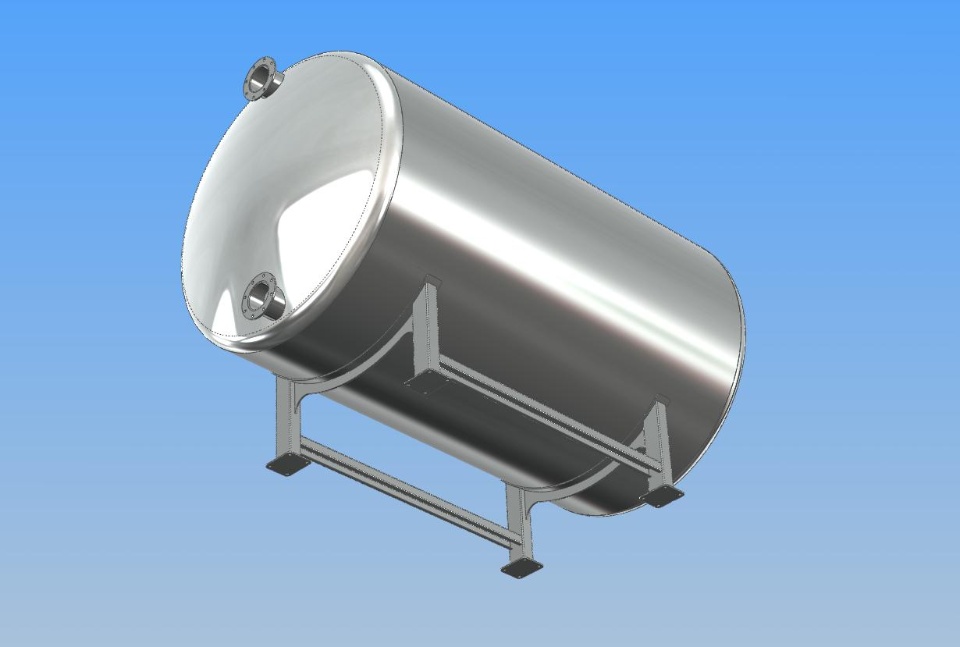

This is just a simple example of top-down modeling, in real life the assemblies are a lot bigger and complex (some opf them have over 3000 parts and several subassembly levels), but the pinciple is the same.

The model I posted here is only a very simple example of how top-down modeling can be done.  A long time ago I also posted a simple macro to update all DT's inside a model.  I belive it still here in the forum.

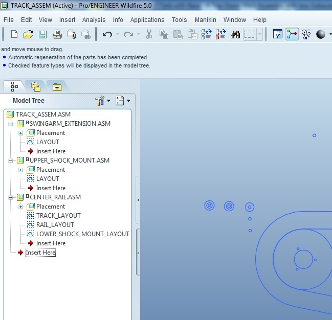

So am I correct in saying nobody uses SW blocks to great things. I have tried and the are a pain in the aZZ.
I have used your techniques in pro/E as well and they work much the same. I have thought of a new way of doing this that I am going to try and implement shortly. The problem I have is that if I use one master sketch to do the whole assem than I get a fairly messy system at the end once all of the sketch is done. But if I make the sketches in the assem level for each sub assem than they would stay small and more reliable(each sub assem is parts that are mated together and do not move, then in the main assem is were I mate them to move with other sub assem. In short sub assem are a collection of parts that all move together). Than any info that needs to be the same in all assems like widths and lengths of certain things I just add as a parimeter in the main assem and can easily send that info to each small sub assem. This also remove the layout part from the bom as it does not exist. The layout is in the main assem and sub assems themselves.
What do you think of this idea. I am doing this in Pro/E but from my experiance they both work the same. Any problems you can see with this design.

The example of the tank, is just a small simple assembly just to show the technique, in real life, our assemblies (which are very large and complex) have a "Reference-Geometry" Sub-Assembly placed inside the main assembly, which contain Sub-Assemblies and Parts having only sketches,  then those sub-assemblies and parts are used (an instance of them) inside the actual sub-assemblies the model).
Doing this, you can open just the "referece-geometry" sub-assembly or any of the reference-geometry "parts" and edit them without having all the 3D solids loaded,  also any change made on any reference-geometry sketch will propagate to the entire model.
We do not do "large sketches" in fact what we do is a large number of small sketches inside parts (that do not contain any feature) so we can insert them where they are required.
Is similar to what you describe, the only difference is that all the "relations" are build inside a "reference-geometry" sketch.  Using this approach, you can have several versions of the "preferential-geometry" sub-assembly and as you "replace" this assembly inside a large model, the entire model will change.  So you can have 1000 variations of the the product having a single 3D model and one "referential-geometry" sub-assembly for each variation.
Is to complex to explain without looking into a large model and see the structure and how all the components are linked, but I believe ths will give you a good idea of how we do it.

Just an update on what I did. I used the idea I had in the previous post. Here is a quick recap:
I made each sub assem to include only parts that move together(as an example a hydraulic cylinder would be made of two sub assems)
I then included any universal data in the main assems parameters(its kinda like tables only not as good)
I then mated all assems together based on there pivots(this could all so work to link parts that don't pivot but that's not what I wanted here)
Now if I update any main perimeters all the sub assem that need any updating will update. And if they don't need to update they don't, saves on reload time as the way I did it before all sub assems used the same MASTER sketch so to speak so if you changed anything Pro/E wanted to update everything.
As of now a much better system.
Once again I know I am using Pro/E here but the idea is the same and will work much the same in both programs.
I have attached a pic of what my sidebar looks like with the assem and sketch inside them. I dont accually have any parts in them but you can see how its layed out.
As for you Mauricio is this what you are saying more or less.
You have a layout assem with layout and part SKETCHES that is added to you accual product assem. Then you reference these for whatever needs it to make you actual product. The layout assem and sketchs is linked to your table to get its measurement and the table is linked to your configurator which you input information in and in generates the dimensions and whatnot for the table.
I like that but I am a one man show and I can get the complicated with the outside coding and stuff. But for what I am designing which is only a few products and the assems are mostly under 300 parts included all hardware this way will do.(At least until I find a better way of course)
