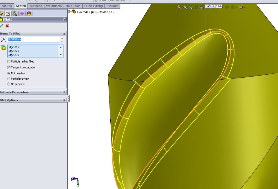

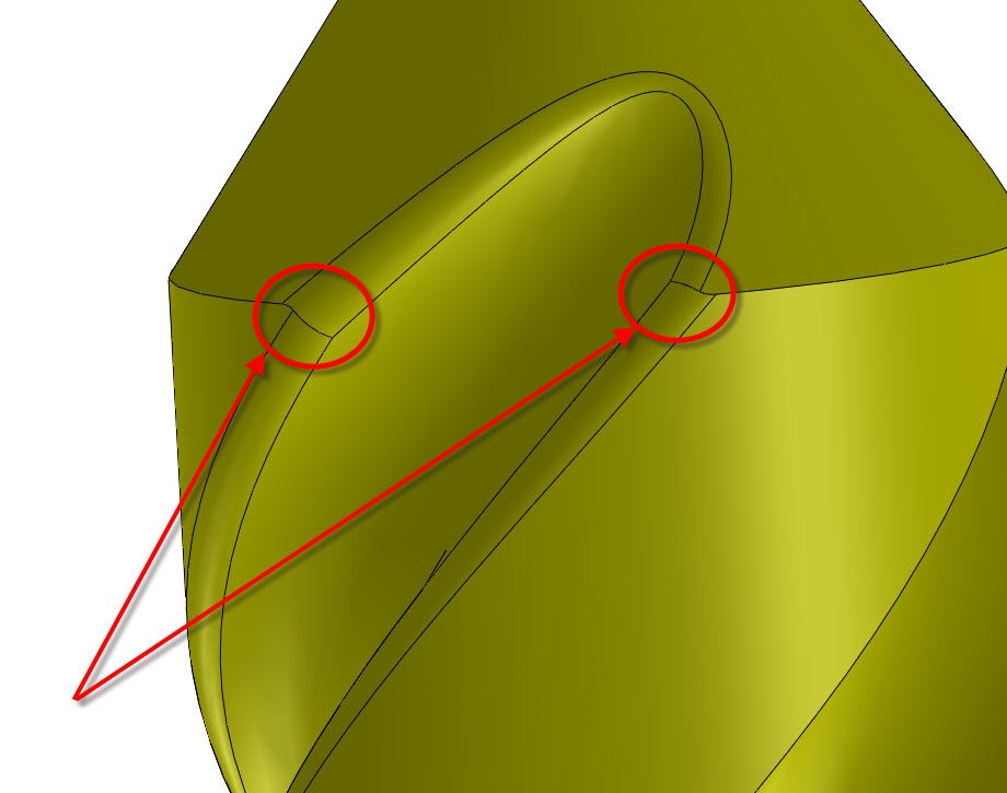

SPR 624854 Possibility to generate constant width face when applying fillet to edges a shown in attached part.

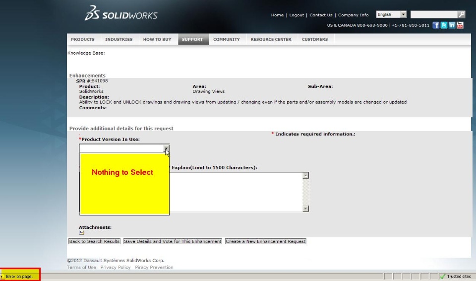

BS
BS 2012-07-20
When I fnd an ER there is nothing in the "Pruduct Version in Use pulldown" so I am stopped from voting
I do have the web page errors.  Is this something I need to go to our IT department or is this something on the SW end?
Webpage error details
User Agent: Mozilla/4.0 (compatible; MSIE 8.0; Windows NT 5.1; Trident/4.0; .NET CLR 2.0.50727; .NET CLR 3.0.04506.30; .NET CLR 3.0.4506.2152; .NET CLR 3.5.30729)
Timestamp: Fri, 20 Jul 2012 13:30:34 UTC
AV
AV 2012-07-20
Have you tried using IE?
BS
BS 2012-07-20
We are using IE 8
AV
AV 2012-07-20
Can you post a screenshot of the error?
BS
BS 2012-07-20
I attached the ER page which shows there is nothing to select in the pulldown.
Here is the webpage error
Line: 8
Char: 4
Code: 0
URI: https://customerportal.solidworks.com/eservice_enu/21238/scripts/sweutil_c_o.js
Message: Object required
Line: 27
Char: 5
Code: 0
URI:
https://customerportal.solidworks.com/eservice_enu/srf1339995617_444/bscripts/all/con
trols_applet_sw_er_vote_service_request_creation_form_applet_eservice.js
Line: 27
Char: 5
Code: 0
URI:
Line: 27
Char: 5
Code: 0
URI:
Line: 27
Char: 5
Code: 0
URI:
Could it be that something on our end is blocking something the needs to load?
Thanks for looking into this!
Bill
BS
BS 2012-07-31
I am assuming since I am the only one with this issue it must be something on our end.  I will talk with our IT.
Thanks for your time.
Bill
AV
AV 2012-07-31
Bill, I would suggest contacting your VAR, also.
