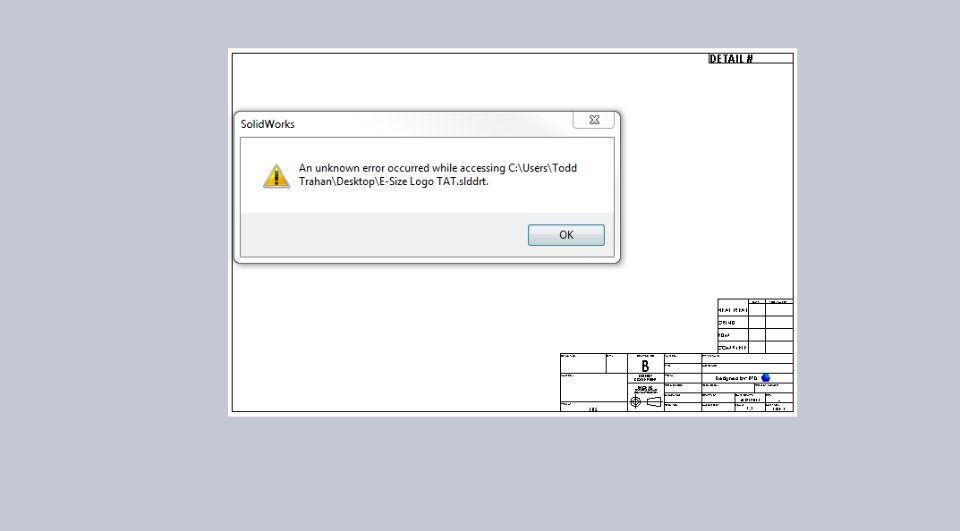

You can always copy the template file ".drwdot" and rename it´s ending to ".slddrt", then you´ll have a sheet format file.
SD
SD2015-12-07
SW is known for hating when things are saved directly to the desktop... this may be your issue. Try saving things to a file folder on the desktop or to your C: drive. Also where is your file location set for drawing templates and sheet formats?
GS
GS2015-12-07
Sarah makes a good point. Wherever you save it to, be sure you're pointing to that location at Tools > Options > System Options > File Locations > sheet formats. Also, I assume you're trying to save the sheet format by going to File > Save sheet format, not directly to Save as..., as you do for other file types?
