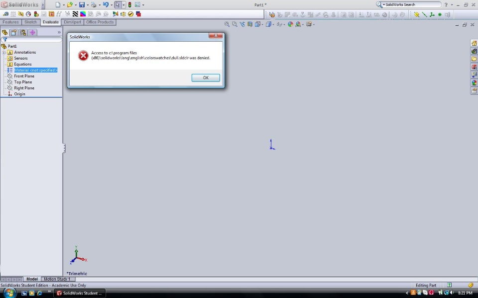

When I try to assign a material for the part on SolidWorks 2009-2010 (64) on a Vista, I receive an error reads as:
"Access to c:\\program files(x86)\\solidworks\\lang\\english\\colorwatches\\dull.sldclr was denied" (Screen shot is attached)
I suspect there is a conflict between the new version and the previous 2007 version installation. I deeply appreciate if anybody could help me how to solve this issue.

AV 2010-02-23 Best Answer
As per Solution S-036599:
#1: Check the referring location for the material database: Tools > System Options > File location > Material database folder. Check that the path is correct and pointing to the correct material file.
#2: It could be due to the Windows Vista® operating system’s (OS) program files. The Vista OS encapsulates all files within the programs files directory and does not allow users to modify files within the program files folder. If the user would like to access the files, the user must copy/paste the files to a location outside the program files directory, such as C:\SW Data\. It is also possible to turn off the Vista functionality, by going to Control Panel > User account and then disabling the “User Account Control UAC” setting.

Alin,
With your first suggestion, I checked the paths but there wasn't a correct one. I tried to create however I couldn't find the folder for the materials.
I turned off the UAC which solved the problem.
Thank you so much.
