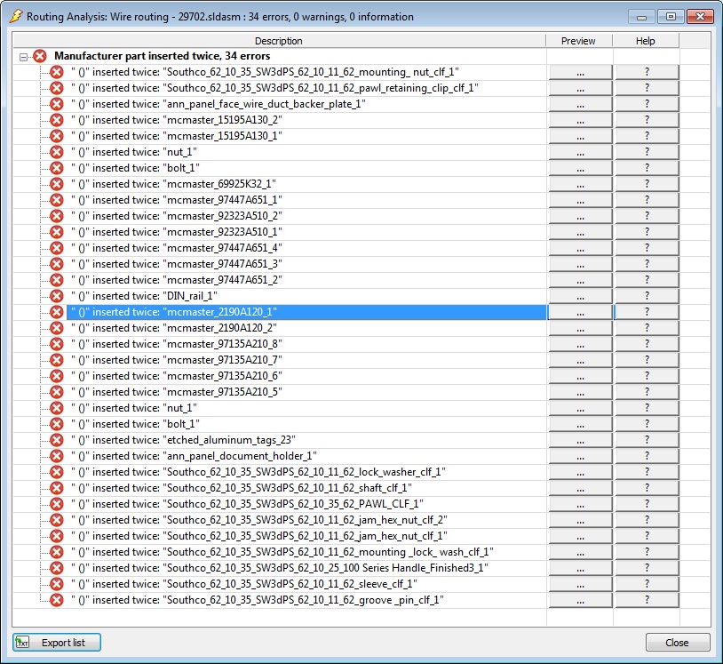

I am having issues when routing wires in SolidWorks Electrical.  I get the error that says "Manufacturer part inserted twice."  I understand how this error works - that it looks for the correlating component number in linked components, as well as the designator and checks for duplicates.  What is strange is that the only components that it shows in the list are non-electrical components that have no electrical intelligence and are not even in the 2D schematic (ie. nuts and bolts).
I have navigated to the components in the list and none of them appear to have any link to the 2D schematic (by accident, or otherwise) so I am stumped.  This appears to be holding up the routing of the wires, as it only routes about 25% of the wires and then stops.
Has anyone had this issue or do you have any suggestions on how to work around this or resolve the issue?  Perhaps there is a way to make it route the wires even though there is an error?  I have discussed this with my reseller tech support and they don't seem to understand why this would happen.  They are looking into it but I haven't gotten any help yet.

Update:
I was able to eliminate the errors with a work-around - by suppresssing all components that show up in the list (which is a total PITA).  However it still did not route all of the wires (still only 25% maybe).  I even verified that all of the electrical components were linked to the 2D schematic.
What would keep it from routing the remaining wires?

I was having same issue with electrical routing and I find solution for that. You can't use ANY sub-assemblies on associated routing part (not even non-electrical bolts), all have the be parts and mate them on the routing assembly.
I was facing same problems with sockets and switches, trying to use (sub)assemblies there. Not working. Lot's of frustrating work. Trying to use those because of bill of materials.

What's strange is that when it routes some of the wires that do get routed are between different assemblies that are sub-assemblies of the top level assembly.
I am going to try to eliminate the sub-assemblies as a test to see what happens.
